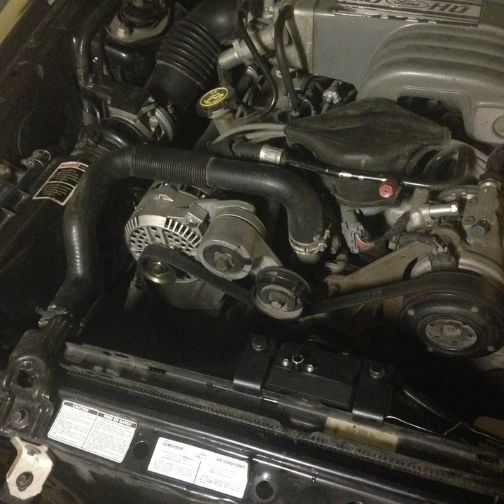

When I rev it I can hear the wind woosh and it sounds like a semi truck. Tried to spin the fan manually and it will not free spin at all. I'm calling it dead and figure it's time for my first upgrade.

Between half price day at the parts yard and Craigslist I was able to upgrade the alternator to a 3G unit and install a electric fan with controller for about $80. For now it fits the bill and keeps the car cool/charged, and quieted the thing down quite a bit.
