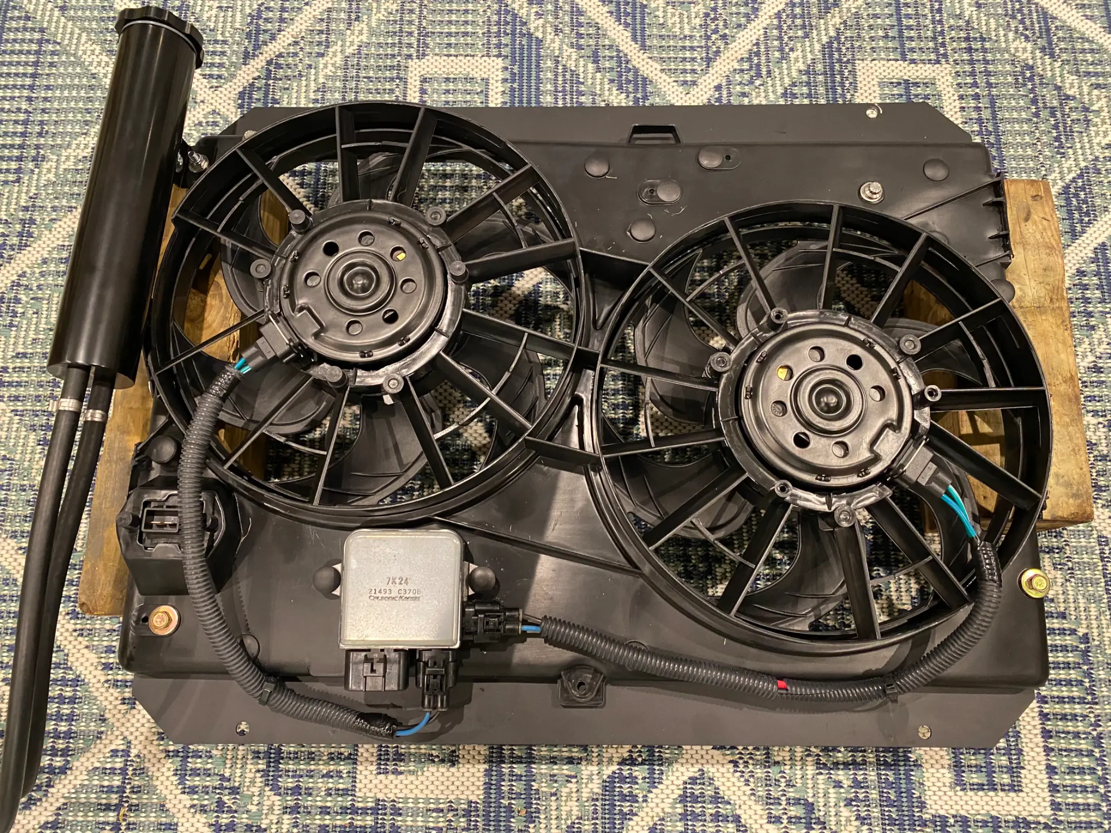

If I ever did electric, I'd probably go for one of the newer brushless versions. Otherwise, the Mark VIII fans are the only ones that really come close to moving that air through the cores.

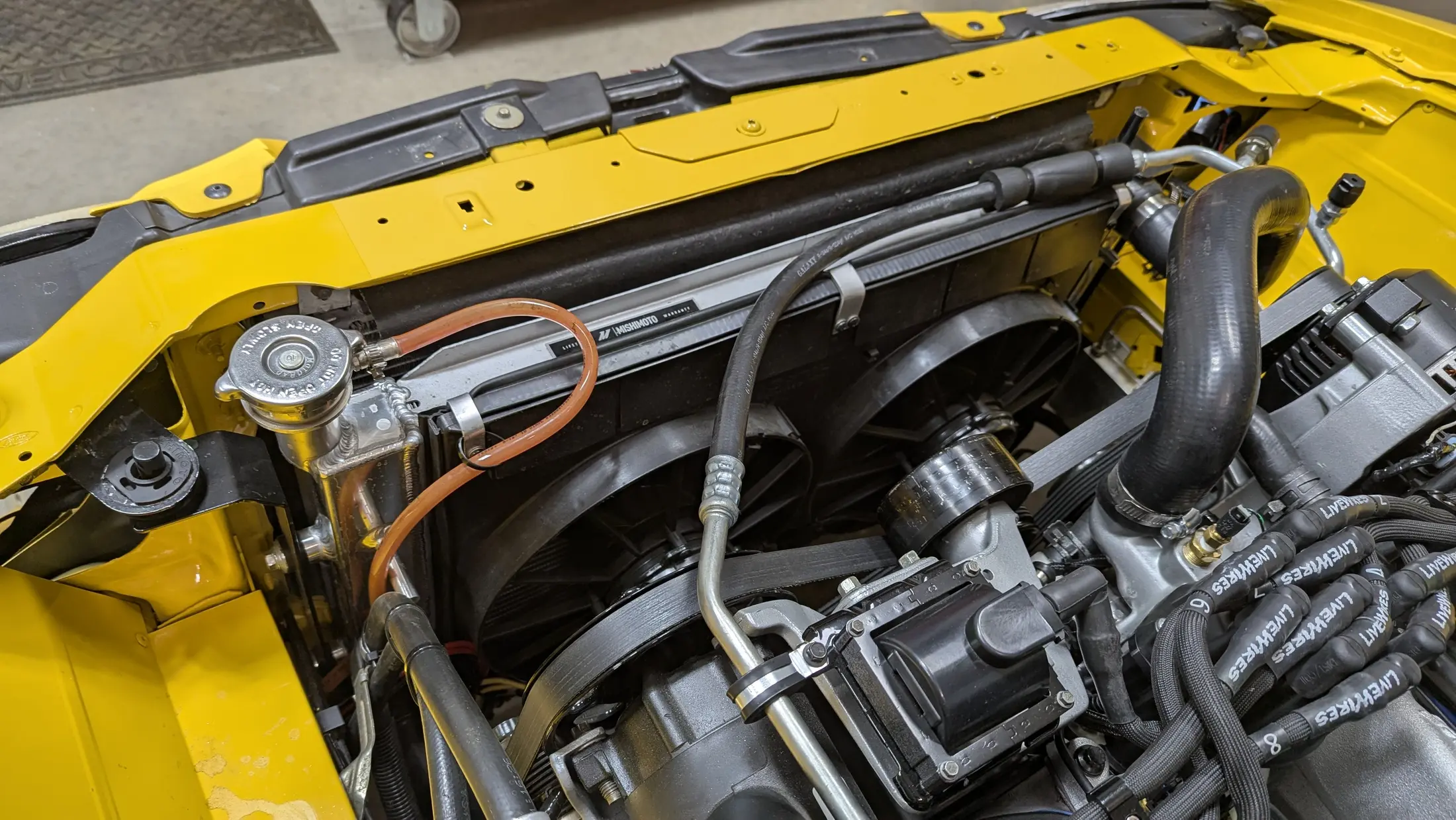

Not knocking the simplicity of the fan clutch setup, but e-fans can be set up to be pretty darn reliable and efficient. I don’t even have my fan set to be on most of the time. Above 40mph it’s off.
