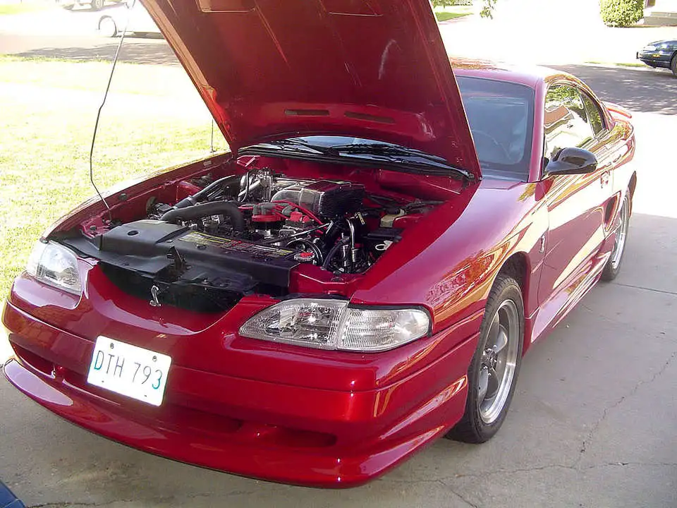

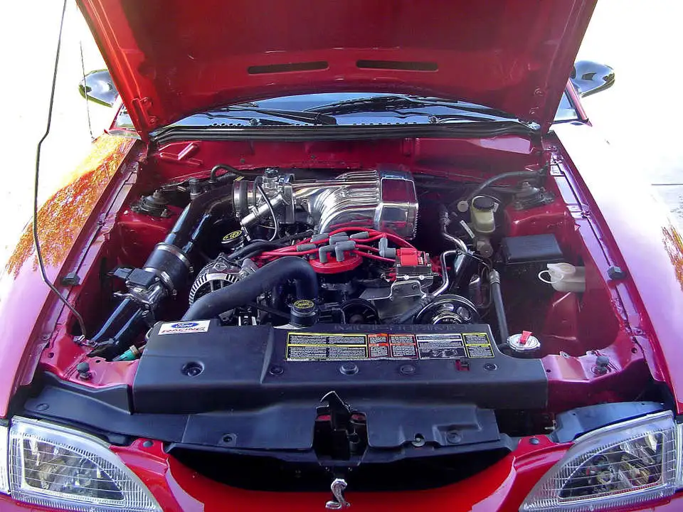

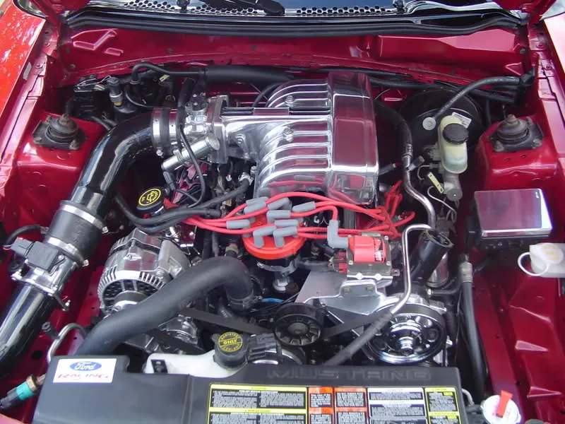

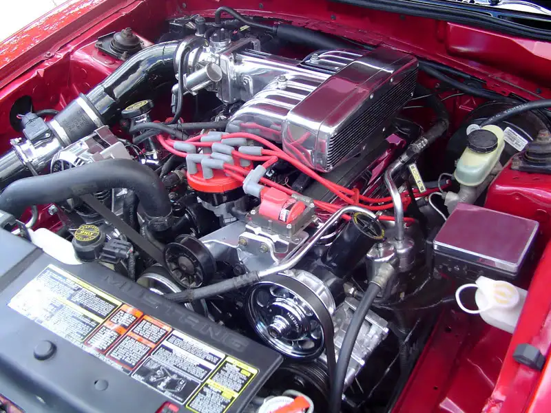

heres what i did in my engine compartment.
i still run a/c, powersteering, and a gutted smog pump (sleeper look LOL)
delete your EGR and push the plunger in the sensor halfway so it wont turn on a CEL. you will get a soft code but no CEL. block the bung on your passenger side header with a 5/8 (close enough) brass fitting from the hardware store or run fox style headers. get a 351 fuel pump block off plate to go on the elbow unless you run the fox TB setup.
delete you AIR by removing all the solenoids and hoses. remove the steel lines that come off the back of the head and plug them with a 9/16 bolt or get the special inserts to block them off. theres a few vacuum line you have to plug off and then shove them into the fender. run a short belt, or buy a idler, or gut the smog pump.
i did this first and it made a huge difference in appearance.
the next step was hide all the wiring, relocate the battery, and paint the engine bay. when i look at my friends mustangs and others at car shows, i almost laugh at how nasty it looks under there LOL
EDIT: almost forgot. hide that ugly hood release cable into the fender. that was one of the worst things i hated to look at. it was probably the easiest to.
sorry man, you just had to ask. i dont want to be one of those pic whores like some people on here LOL JK'ing
its going to look alot better this fall when i get the car out of storage. i have a lot more bling to add.

just some 3inch piping i had laying around. that was probably my 4th or 5th CAI i made. the first one i made was around 3in and was for my stock intake. 2nd i did some improvements. 3rd was the new 3.5 inch fox style with the EGR spacer. the 4th was with the Fox EGR delete plate i made.
