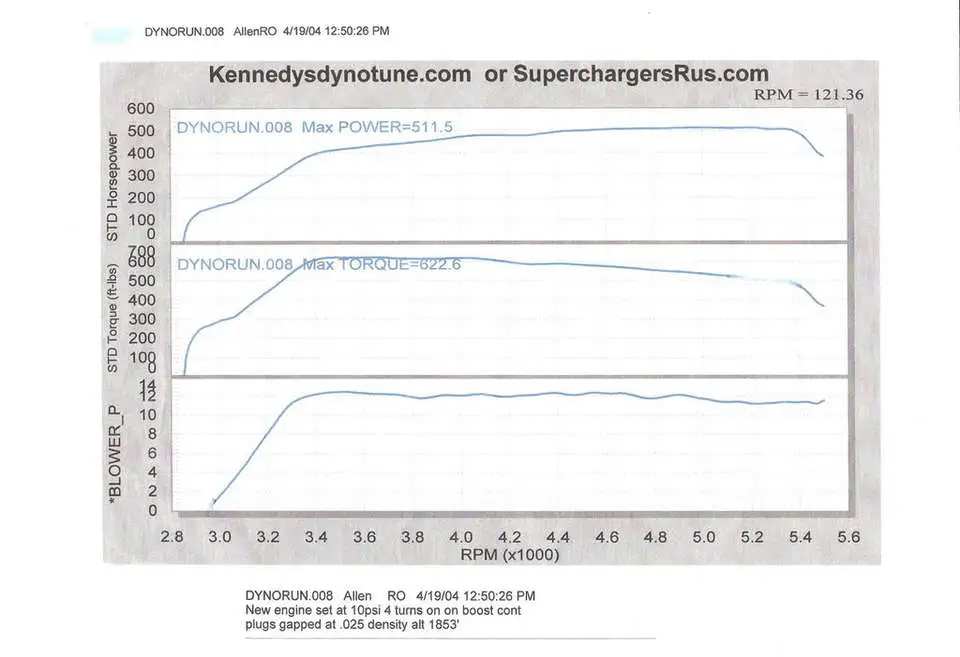

I've been running a turbo on a DSS Pro Bullet with 331 stroker kit ( stock block, just dressed up @DSS) for 8 years and 30k miles. It can be done , but you must know that you have good air/fuel( gotta have a good wide band, such as Innovate) and don't get too greedy. You must be sure your tune is good. i have been running 10psi on the HP kit, making 511 rwhp and 622 ft. lbls. rear wheel torque. Any questions ,feel free to pm.

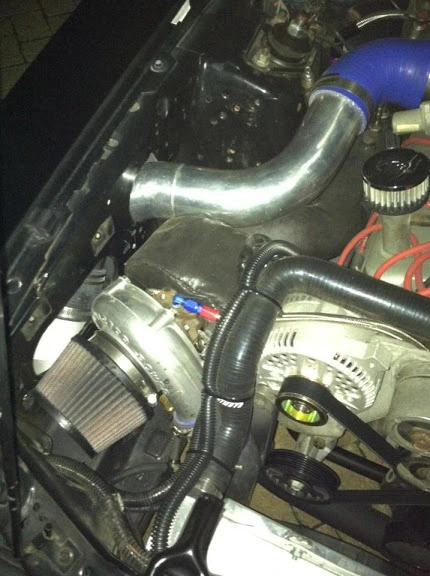

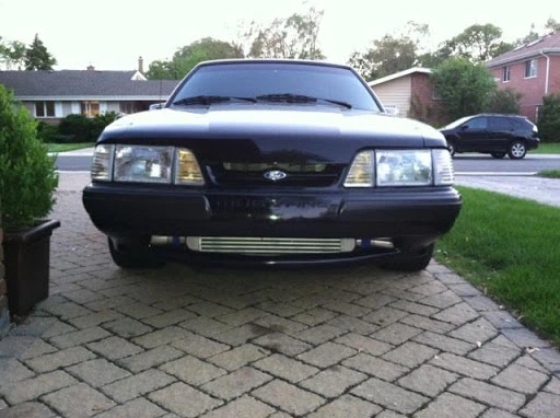

I have the B&G 70mm kit. Really nice fitment with no cutting. No A/C, but there is room for it so I will likely ad it someday. It's set up at 8psi with the stock block. I just drive it to work occasionally and to cruise nights. So far so good.
