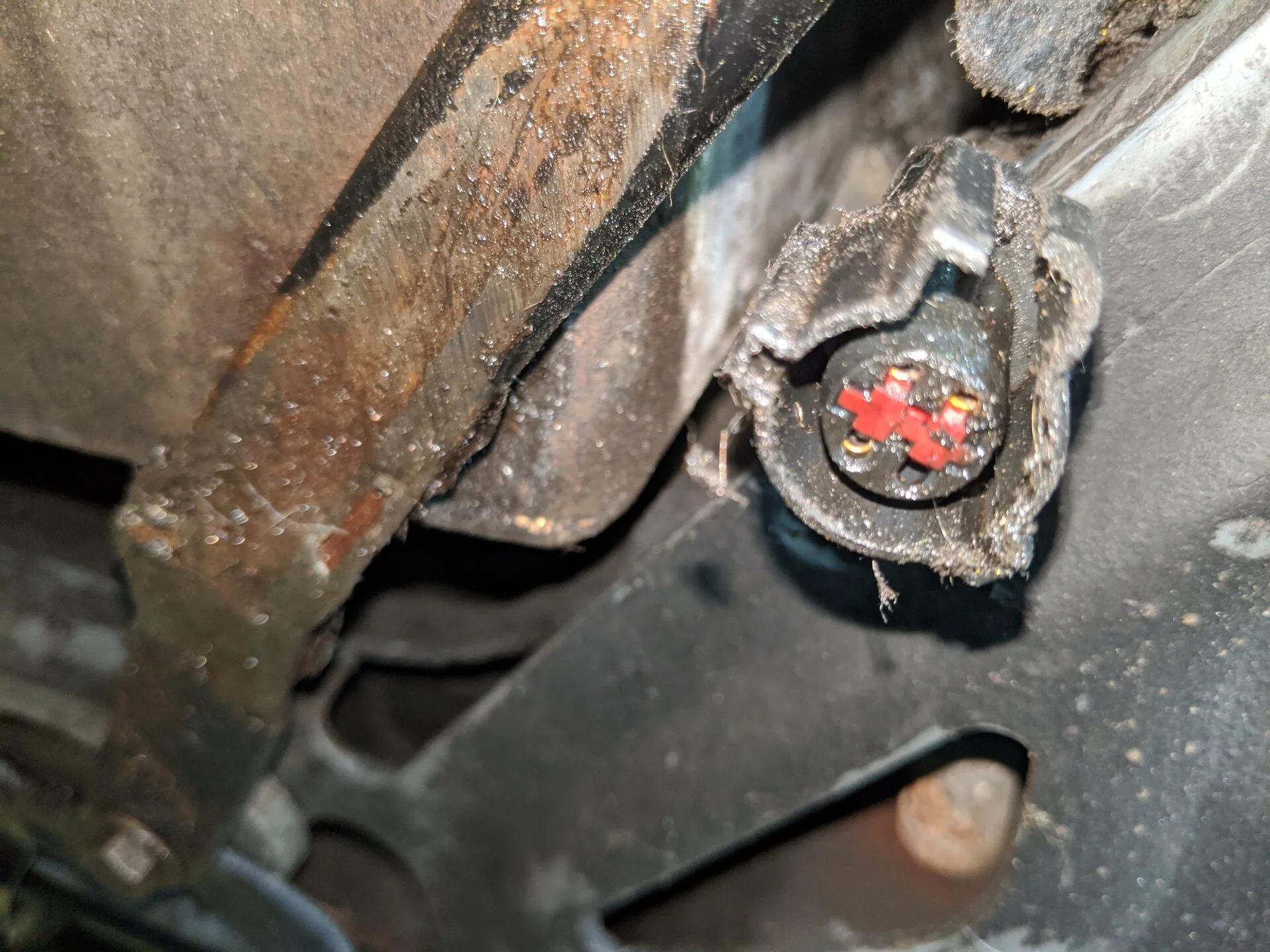

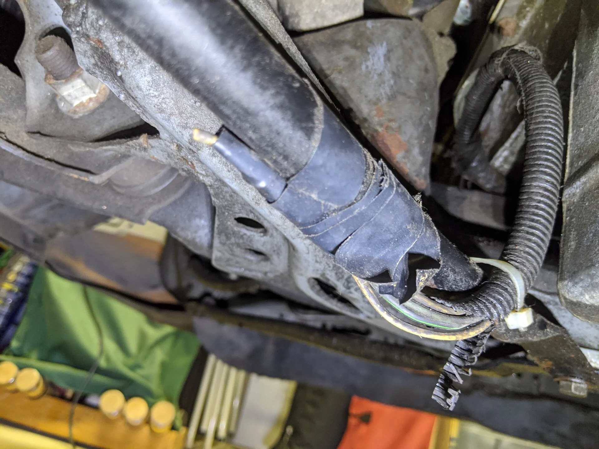

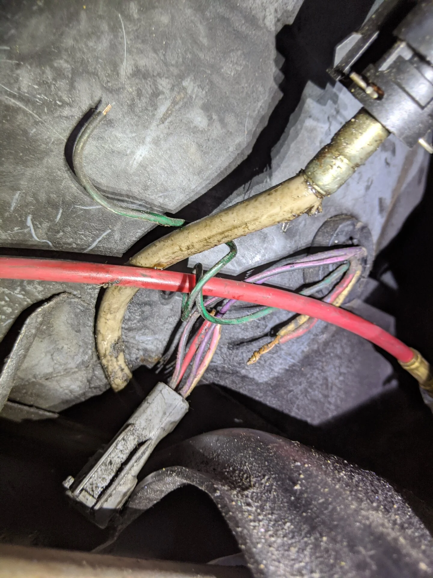

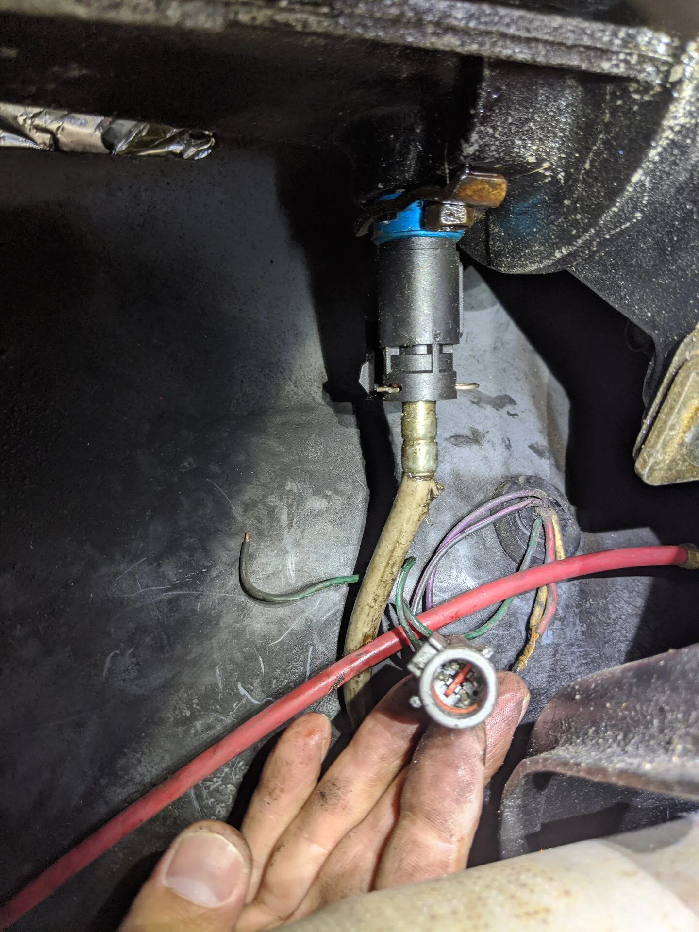

Hello, can any help I'd these plugs? I believe the last 2 plugs ( one doesn't have the plug just wires) are the 02 plugs.
The car is an 89 vert with a c4 tranny and a b and m shifter. I have had this car for to long and this is my first ford/ fox.
I know the vss plug isn't there. Not sure what area it come from so I can look for it.
Car runs pretty well. It does have the occasional shut off when slowing down. (I believe the vss would fix that).

Nuetral gear switch. Tells the ECU the manual trans is in nuetral. It’s not present on AOD cars.
was the car originally a 5-spd or AOD? I can’t actually see the wire colors to confirm if it’s there.
but that harness is this one
There are three connectors on it. One is the VSS (2-wire) one is the Nuetral Safety/reverse light harness (4-wireplug) and the msnual cars would have a 2-wire plug for the NGS.
