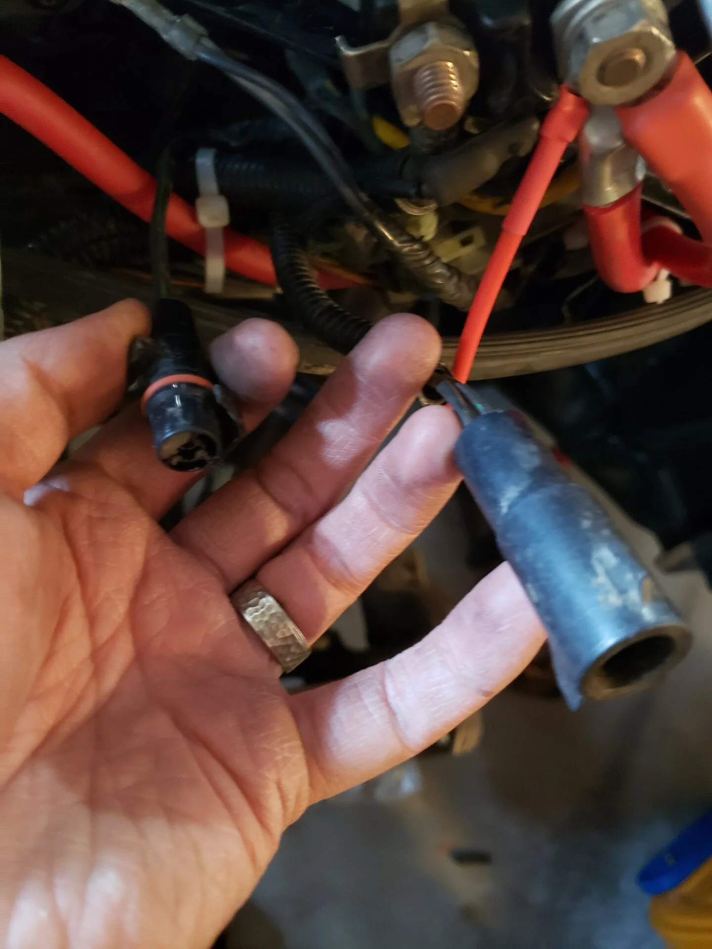

hemi_fan Active Member Apr 8, 2004 279 3 28 Ontario, Canada Jan 9, 2021 #1 Jan 9, 2021 #1 Hello, does anyone know what this single wire connector is for? Ground for something? Its on the drivers side harness. I'm in the process of reassembling the car and its not apparent where it goes. The 2 wire is for AC I believe. Attachments 20210109_161447.webp 136.2 KB · Views: 204
91GTstroked 15 Year Member Jun 14, 2007 514 284 93 Jan 10, 2021 #2 Jan 10, 2021 #2 Is it the ground plug for ECU? Negative factory battery cable has a cylinder style plug for ECU ground.
arnie93lx Active Member Oct 1, 2005 105 19 29 Columbus, OH Jan 12, 2021 #3 Jan 12, 2021 #3 computer ground quick disconnect. It should also be part of the battery negative cable
hemi_fan Active Member Apr 8, 2004 279 3 28 Ontario, Canada Jan 12, 2021 #4 Jan 12, 2021 #4 Thanks, that explains why I don't have the mating connector (relocated battery)
