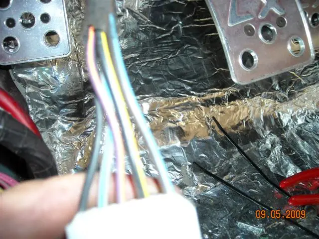

Identify this plug...
It's under the left/drivers side of dash.
Not certain where it goes... unless it's the future for what could be foglights on this 1992 LX.
TIA.
Colors are in the following order:
Black / Lt.Blue
Black / Yellow
Purple / Pink
Gray / Blue
Black
This is a 1992 LX Convertible which did not have a defroster in the rear convertible glass. Perhaps it is related to a defroster...or lack of.
Where you have BK/LB I'm showing BR/LB and your P/PK is P/O here. The wiring order is the same so it's likely the same connector. If you don't have rear defrost the connector was probably just taped up somewhere.
