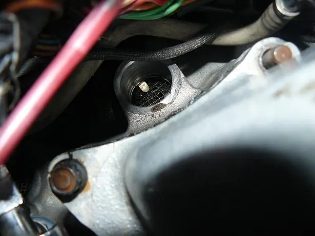

PCV screen looks pretty clogged up to me, cleaning it now.

So I cleaned the PCV valve as best as I thought I could, and while I had the valve off and the screen removed, it seemed like the oil drip stopped. The car was sitting in the garage for 5 hours and not a drop hit the floor. After the cleaning and the O2 sensor swap, I put everything back together and ran it, doing KOEO and KOER tests. The lean condition disappeared, but a few new ones showed up. I did two tests, and got different results each time. All the codes I saw:

And I found a new PCV filter screen and slapped it in. I'll put the filler cap back on (the hose from the throttle body to filler neck is installed), giver her a run, and see how we do. I'll keep you posted.
But is having a breather and the functioning PCV really that bad? The engine is far from stock, and the compression is definatley higher.

Might want to put a nut on that one that's missing on the upper to lower stud.
Also, is that RTV oozing out from between the upper and lower?
