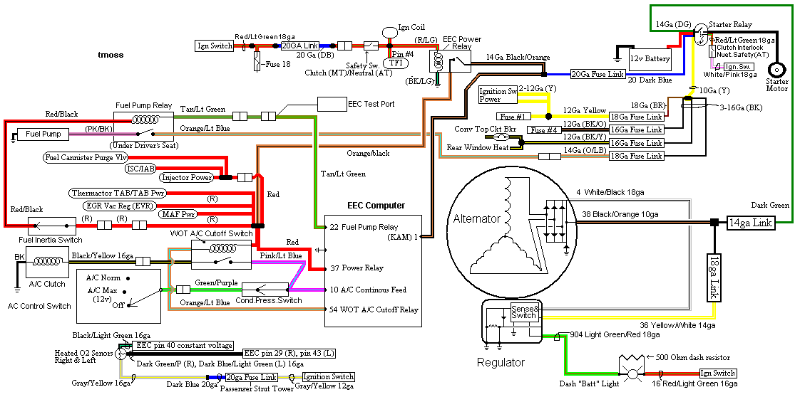

sometimes the fuse should will go before a wire would burn in two, so if it's not a fuse somewhere (not all are in the fuse box) then you may have simply missed one. Use a volt meter and follow the wire to find where you do and don't have voltage to narrow it down.
I would use an ammeter to see if there is any power flowing out of the battery into the system and shorting somewhere. If that surge of electricity heated the wires enough you could have two wires somewhere in the harness that melted the insulation and are now contacting, or even a short to ground. That's all speculation until you test test test. Are you getting voltage to the fuel pump at least? test test and more test
