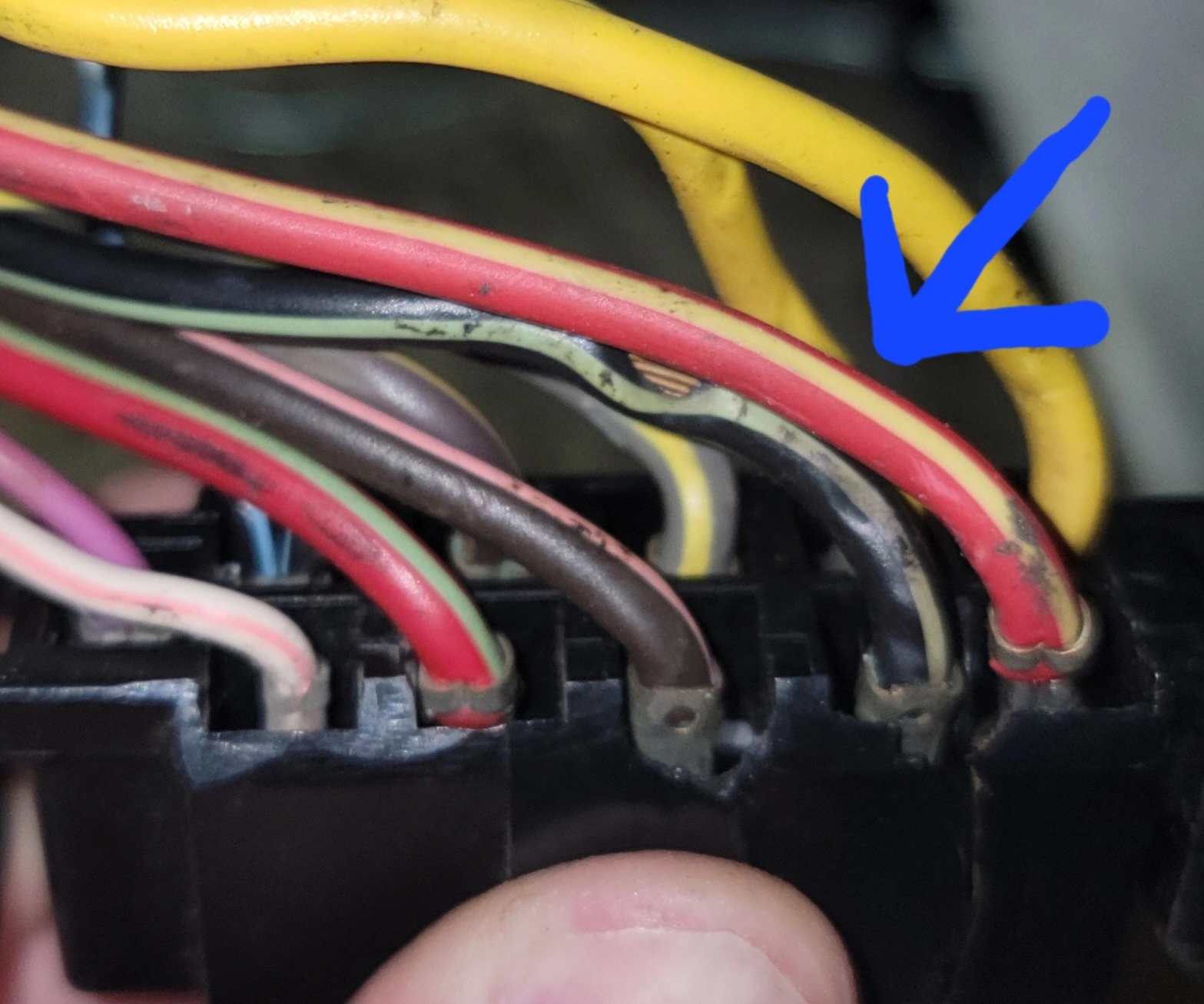

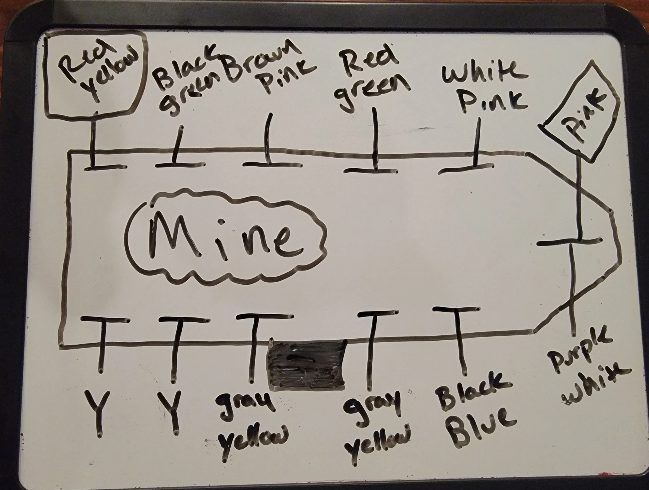

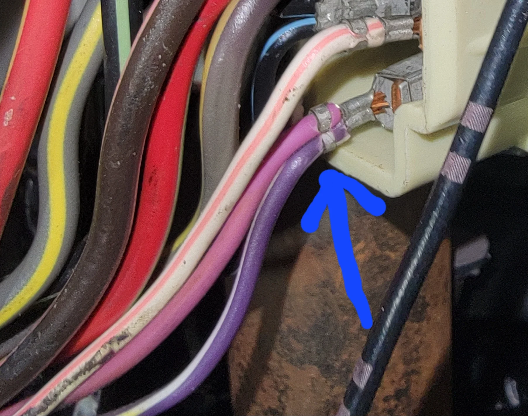

I had intermittent turn signals so figured it was time to replace the ignition switch. Sure enough, it was coming apart. I replaced it and now I have no headlights. Figured it was a bad pigtail block so painstakingly documented wire position in place and then depinned the harness.
There was no change
So I tracked down the diagram and ran into a mostly correct harness except for 2 wires not accounted for.

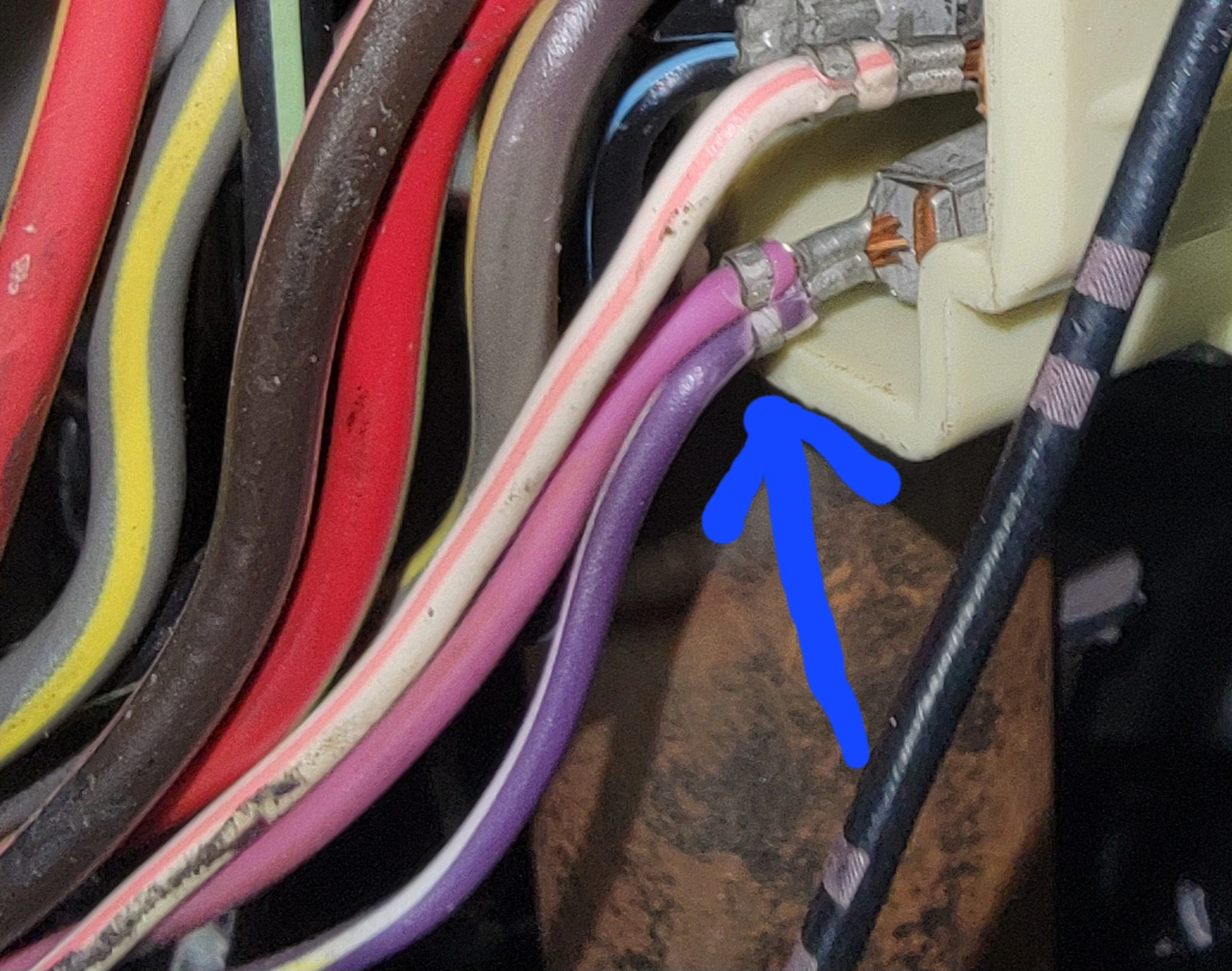

I have an extra pinkish-purple wire connected to the pink/white at the base of the harness and the one port that is typically open, is filled with a thick red and yellow.
Now all these wires look very factory, but no idea what they are.
Before I cut the loom and start tracing these all the way back, any ideas?
I rewired my headlight switch with a new pigtail from LMR last year and that is all tidy. I suppose I could have fried the switch but when I pull back on the flash to pass, the headlights light up just fine and all was working before I swapped out the switch. These really look like factory spade connectors and crimps, I'm just guessing they were meant for somewhere else? Or possibly the bad switch was making contact with something that made it all look correct but it wasn't? The only noticable issue is the headlights.

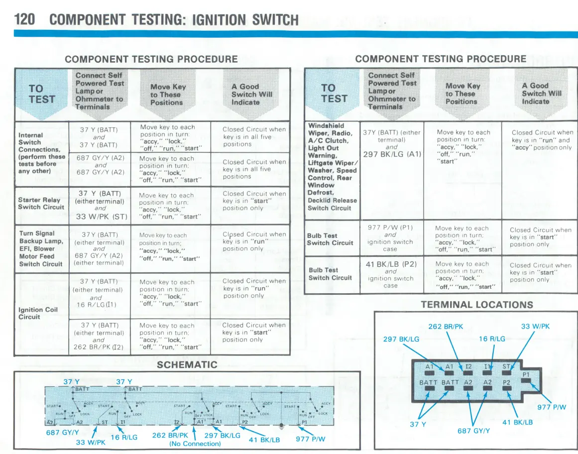

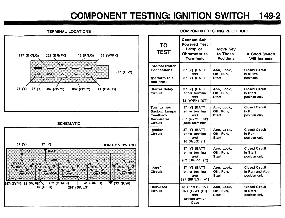

at this point im just searching all the "veryhelpful" diagrams to see if I can figure out where this wire should live, that port on the iginition is supposed to be empty. It must have something to do with the headlights either power or feed to the fuse.
Wire 977 (purple/white) appears to be a ground. If you test continuity of these wires to ground, i imagine it should ring out. BTW, it's entirely possible that the pink wire is really a faded purple wire, but i can't see if it's solid or also has a white stripe.
Thanks to everyone's help I found and fixed the issue!
I have no earthly idea how it got to this state but likley has something to do with the work on the stearing column that was peviously done on this car. The wire at A1 (as seen above) is open, and the wire I had there was the power feed from the multifunction switch. At some point someone thought it went there and actually taped it all up with the other ignition wires........
So all I can surmise (because at this point I cannot recreate) is that the ignition switich was coming apart so badly that power was somehow backfed to the dash switch, causing the headlights to appear to work normally. When I installed the new ignition switch, this accidental success was cut off and the lights no longer worked and once I plugged it back into the right port on the multi-function switch, everything was back to 100%.
No clue how long this has been this way, I've owned and have been working on the car for about a year and a half and the dash headlight switch was rewired by me as it had been previously fried. I've had it in running shape for about 9 months but it was running really badly and only occasionally starting when I got it. Who knows, may have been a project that never "ran right" and it was not like this for too long.
Amazed it did not burn to the ground with all the scooting around town I've done with it in the last 9 months. Good thing I did not drive it to Foxtoberfest like that as planned last fall!
