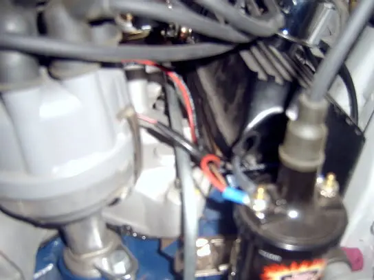

Guys, after searching the threads and do some reading I am still unable to get the car to start. I installed the ignitor but am confused as to what to do with the wires coming from the firewall and the ignitor wires. There are two wires routed on the passenger side one went to the negative terminal on the coil and the other to the distributor and three wires on the drivers side, two of the wires connect to the block, the remaining one connects to the positive terminal on the coil. I attached the a picture of the positive wire(s). Thanks for the help and any one with pictures please attach them because i am more of a visual person.

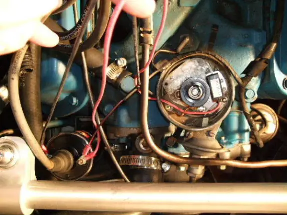

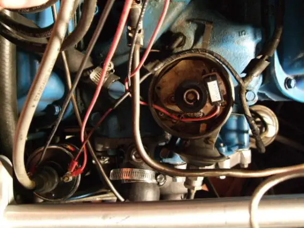

None of the wires that were attached to your old coil should be attached to the new one. Check these pics and you'll see that I have two wires coming from the distributer. Red goes to the + side of the coil, black goes to the - side of the coil. The black wire that's on the + side is the 12v switched lead from the backside of the ignition switch. As far as what to do with the old wires, tape them up and out of the way and you'll be fine.
Sorry about the fuzzy pics, but hopefully you get the idea!

There were no other wires going to the coil with points ignition. The black wire from the distributor went to the negative side of the coil, the hot from the ignition went to the positive side. The only other wires to the engine were one to the temp sensor, one to the oil pressure sensor and possibly one to the choke. And if A/C equipped, one to the A/C clutch.
The red wire from the ignitor goes to the positive terminal on the coil. Black goes to the negative terminal on the coil. Along with the red on the coil, the hot wire coming from the ignition goes there also.

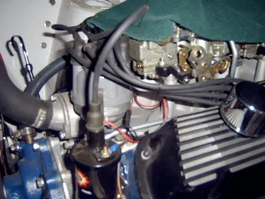

Had tried this previsouly with no luck, gave it another shot just to make sure and still nothing. Any more ideas? Attached pics so the wires in question can be seen.

Where did you get the 12v wire to power everything? If you just reused the original wire, that's your problem. That wire is attached to a pink resistor wire back in the loom and will cause you no end of trouble. Go directly to the back of your ignition switch and get it from the source if you haven't already.

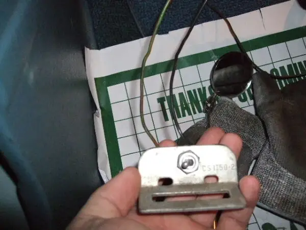

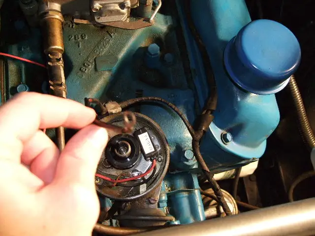

Found the two wires connected to the neg side of the coil were from a kill switch under the dash. So now I am left with the engine gauge feed that includes oil sender, temp sender and the pink wire to the positive side of coil. Connected the pink wire and the positive wire from ignitor to positive side and the ignitor negative wire to the neg side of coil, still nothing. Is the pink wire a resistor wire that needs to be bypassed?

Went and got an early Christmas Present at the auto store, bought a multi-meter. Continued trouble shooting with all wires back to stock setup and am getting 12 volts at the coil with ignition on, did not have anyone turn car over while checking volts. I am begining to think I fried the ignitor. Anyone have additional areas to check for problems and how can i tell for sure the ignitor is fried?
I put a link to the Pertronix instructions and wrote it out. THe new wire goes to the red wire on the distributer (Pertronix Ign). Put the ORIGINAL coil wire on the positive term of the coil. THe new wire supplies 12v to the electronic ign. module.
It's possible the module has failed. If it's hooked up properly, either you get spark or not. You can take a test light (not your meter) and probe the neg term of the coil. THe light should pulse on and off as the ign triggers the coil.
