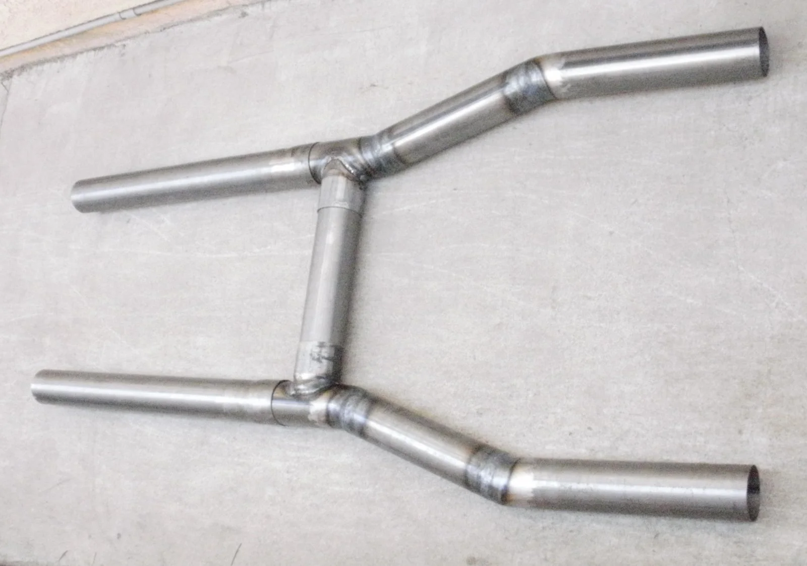

Speaking of H-Pipes. This is RCI's Competition H-Pipe Kit. It runs from the rear of the collectors of Long Tube Headers, all the way back to where the front of the mufflers would be on a FOX Chassis Mustang. It fits in the same exact spot as the OEM H-Pipes that came with the car. No bends and no kinks, and it's available in 2 1/2" and 3" diameter heavy wall tubing. Everything is a slip-fit, you can weld them together or use 2 1/2" or 3" muffler clamps if you wish The center tube in the "H" is adjustable in width. If you have a wide transmission (like an AOD) the length of the tube can be left as is. If you have C-4 Trans or a 5-speed, you can cut a little off of that "H" and make the whole deal a little narrower. I still like the tried and true (and cheap) 3-bolt flanges to hook the exhaust to the collectors (available from Summit and pretty much every muffler shop), or you can let the muffler shop do the installation for you. $249.00 for either size pipe...
