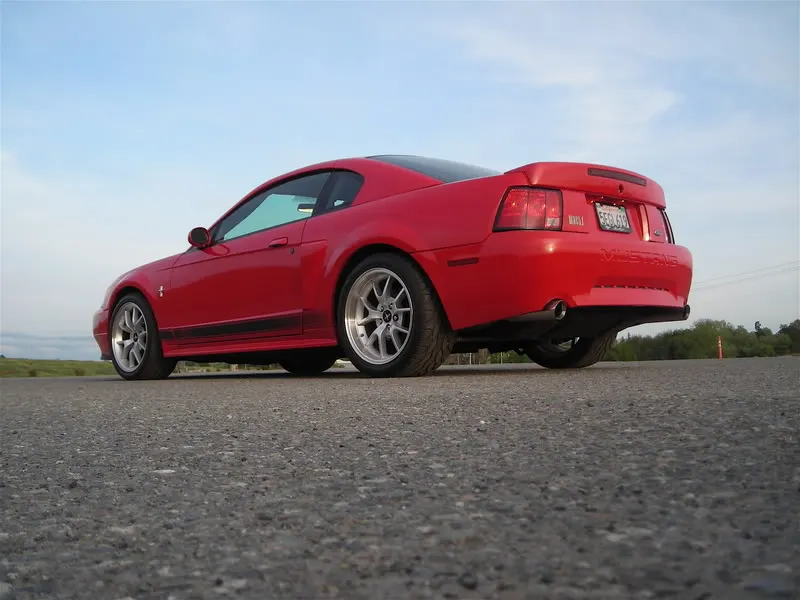

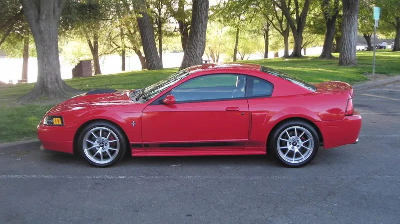

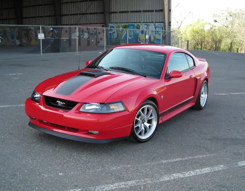

H&R supersport springs, Bilstein HD shocks & struts, & Maximum Motorsports caster camber plates should do the job. The H&R ss's will lower your stang about 1.8 inches, which is just about as far as you wanna go to still maintain a decent ride quality. The bilstein's will match up better with the stiffer spring rate of the H&R's, plus your stockers will wear out fast if they arent already worn out, & be bouncy as hell. & the MM camber plates will allow you to get a correct alignment. Here is some pics of what it should look like after.
Garage queen? Why because its clean? It cant be a garage queen, cuz I dont even have a garage. It sits outside on a daily basis. I dont daily drive it, but thats just because im tryin to keep my miles low so i can supercharge it. Beleive me I drive it & I drive it hard!!! It does handle pretty damn good too!!! Plus I was slightly rearended a few weeks back & those pics were taken the day i got it back from the bodyshop. Had them put on a new chin spoiler while they were at it.That would explain the brand new chin spoiler. already got a few scrapes since then. LOL
Well then congrats on keeping it so clean and driving it like you should. Not to mention doing the right mods that compliment the mach 1 and not take away from it. ;)

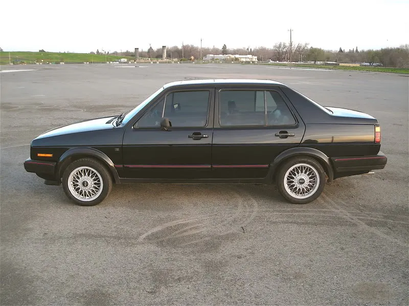

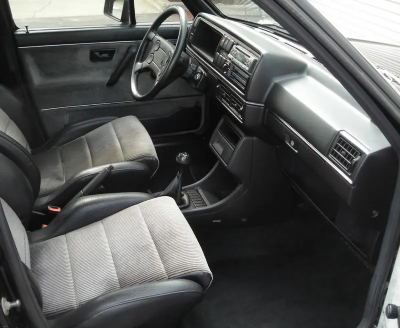

Im hoping to get a spot with a garage soon. And yeah the Jetta is a 8V GLI 5 spd & its pretty clean too. gettin ready to lower it 2 inches soon with an H&R cup kit. Other than that, its stayin bone stock. Anyway AbsentHero, sorry for going off topic on your thread. Hopefully my original post will help you with your lowering ???'s. good luck. & heres a pic of the jetta, like any1 cares!!!
I really dig the BBS rims. I wonder how those would look on my stang. ;) That things gonna look wicked and handle well too. I had a VW quantum syncro wagon as my first car. That thing is still to this day the funnest car i've driven. It was lowered and had BBS rims like those. Mine had a 5 cyl. audi engine though and AWD and 5 speed. I wish I had kept it as a DD. Anyways have fun with the jetta it's nice! :D
Thanks...I dig old school V-Dubs & BBS's too. I had to beg my buddy for months to sell me those BBS's, cuz they are a biotch to find. I just wish it was a 16v though. By the way,I think BBS's & other old school mesh wheels look bad ass on fox bodys because they give it more of a period correct look. Plus they are an alternative to the everyday Cobra R or Pony wheels.
