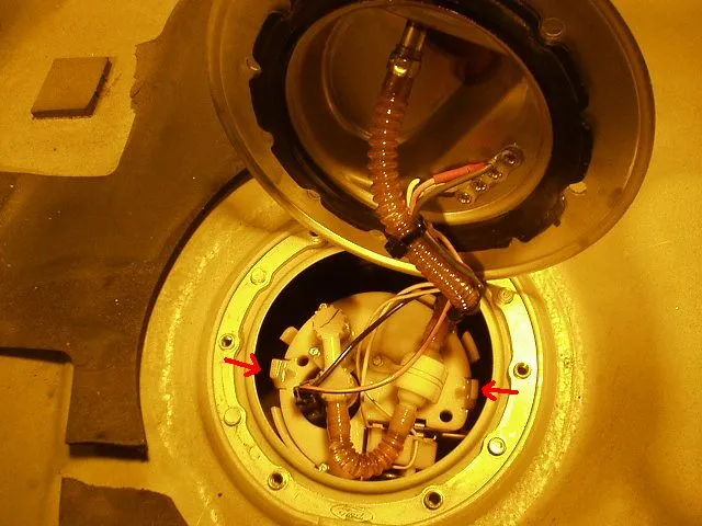

Stumped on fuel pump removal, had never run across this type yet. found a good pic, thought I should post. Not sure what models this will include but this is mine on a 2002 V6 Mustang. Press the tabs indicated by the red arrows to release the pump assembly then lift the pump out.
