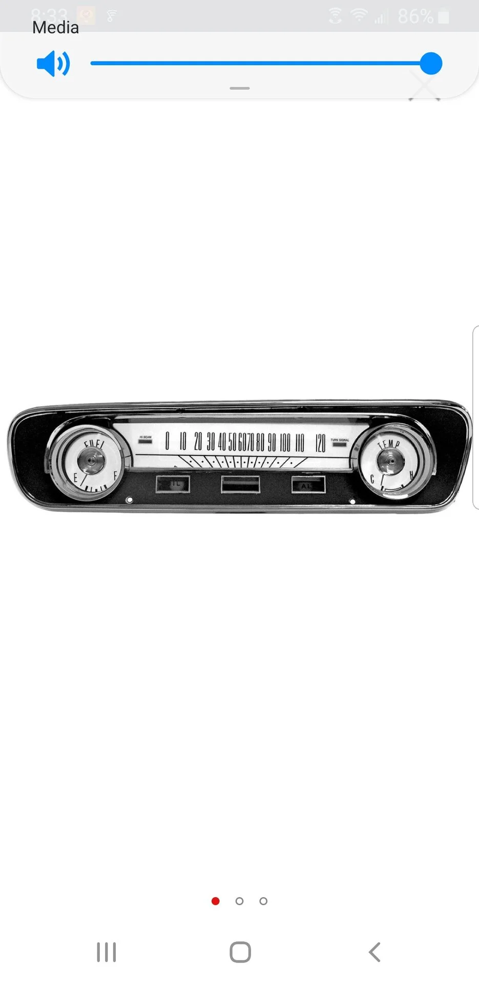

So Im guessing you have this cluster which is the early cluster (64 1/2 - 65) (see pic) so the harnesses and the turn signal switches are different from early 65 to late 65 - 66. Im guessing you either have the wrong signal switch or cluster harness. The early has the turn indication wired into one and the later is separated.

Well if the old one had the same issue and you're positive you have the 64 1/2 - 65 switch then I'll refer to my usual answer that electrical issues especially lights 99 percent of the time is a ground issue. So I'll try to keep this short. So to me that bulb looks like one of the few that operates with reverse polarity. It has two wires connected to it with one supplying power while the other feeds to ground. They then reverse power and ground direction as you change the switch direction. So this means they are likely using different ground sources and one of those is probly a poor ground which could be at any of the 4 blinker sockets or even headlight grounds. It may be poor but good enough to operate the blinker itself. You might be able to watch the blinkers and see if maybe one is not as bright as the others which would indicate a poor ground at that light. I would personally clean each turn signal socket ground and headlight ground. The front blinkers tie into the headlight grounds.
