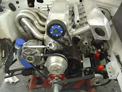

I cant visualize what your saying, any way you could describe it better?
At the moment I am planning on having a slope down from the plenum, sitting next to the master cyl, down to the head. Unfortunately I have to mount the TBs high up, 4-6in from the head, which isn't the greatest but unless I move the alternator I dont have a choice. I thought about mounting the TBs vertical (downdraft style) but the plenum would hit the hood.
btw, what are my chances of mounting the alternator where the a/c pump is? I'd have to figure out a different belt routing and moutning bracket but that would get it out of my way. Thoughts?
Like this:

That's pretty much exactly what I was thinking. Except only one set of injectors... It'll take a little bit of work but I can squeeze it all in there.

I'm seriously considering the change to edis and replacing the a/c compressor with the alternator. That would give me so much room I dont know what I'd do with it! I could get totally crazy with the intake!
