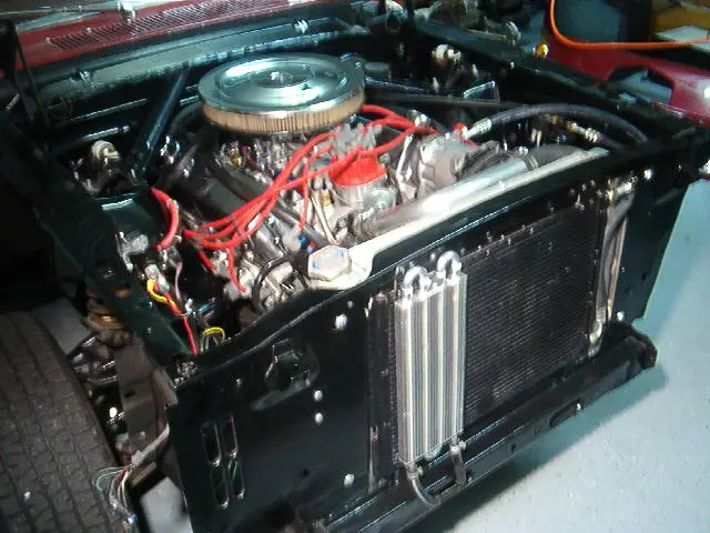

I changed out the 17 inch model on my 66 to a 20 inch aluminum radiator made for a 67.
I cut 1 1/2 inches from each side of the radiator support to open it up.
Also added a recovery tank for the overflow.
Car will now sit in traffic and 100 degree weather without getting hot.
Pictures of my cooling system and information:

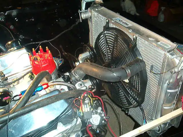

You can get Northern radiators from Summit - I'm removing the battery and going with about a 27" wide one with a dual fan that covers the entire core surface. Don't have the price in front of me, but it was a pretty good deal IIRC.
Even if I don't open up the core support when I install it, the extra width can't hurt, as it is a crossflow radiator and (I assume) the water will flow down the area that's not open to the front, have cold(er) air than the water inside the engine flowing across it, so there will be an initial small cooling effect, then when it goes across the area that's open to the front, a more drastic cooling effect, then down to the bottom on the other side. The wider radiator allowed me to fit a larger, higher CFM dual fan so that made the decision on the width. Summit part as well. I can look up both if you're interested.
It's not much better than Chris66dad's setup, but the extra width can't hurt - I imagine I'll get his level of cooling capability plus a little more.
Here's what I did for my 347...
