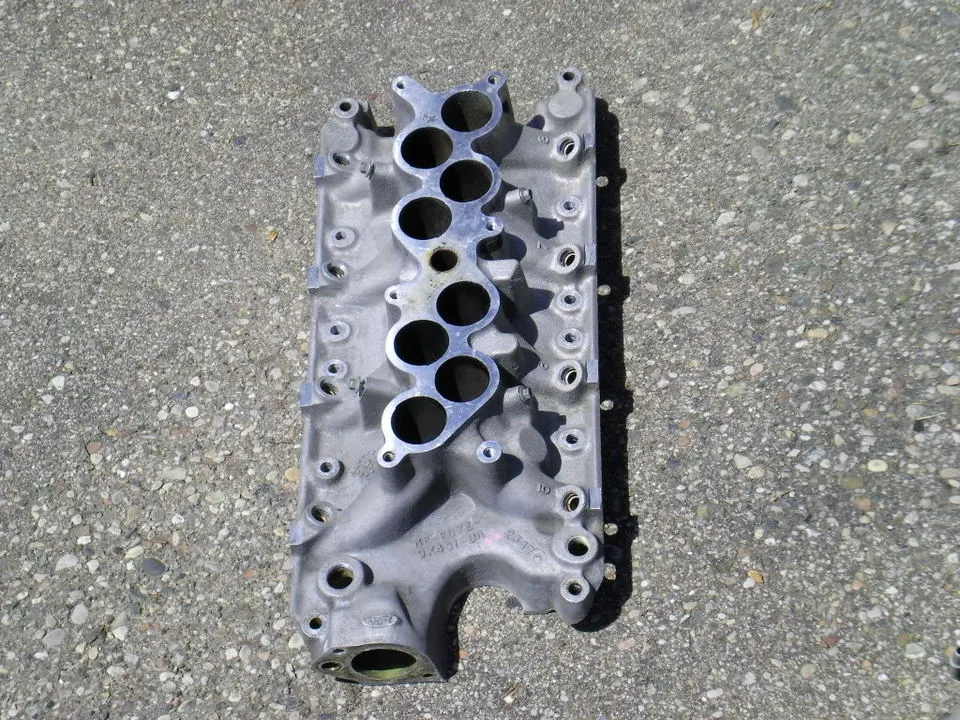

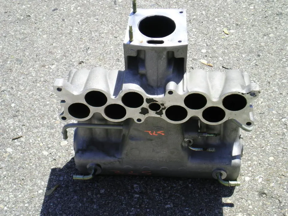

Yeah, I do belive that the 96 would have come with GT-40's and not the GT-40P's. So the heads with bolt right up. The lower intake on the explore and the GT-40 lower share the same part number, but the explorer lower will not have the sensor hole drilled and tapped on the #5 runner. Any machine shop can do that very cheap or DIY if your up to it. The upper is just a cheap cast of the GT-40. It flows about the same. If you need to keep you EGR make sure you get the early explore stuff with the EGR ports. Hers's what both the upper and lower should look like..
$300 is a great price i think. I would grab them.
Now as fas as HP go's. I would say it's a easy 25- 35 maybe.
Grab the TB also and convert it so you can get the 65mm
