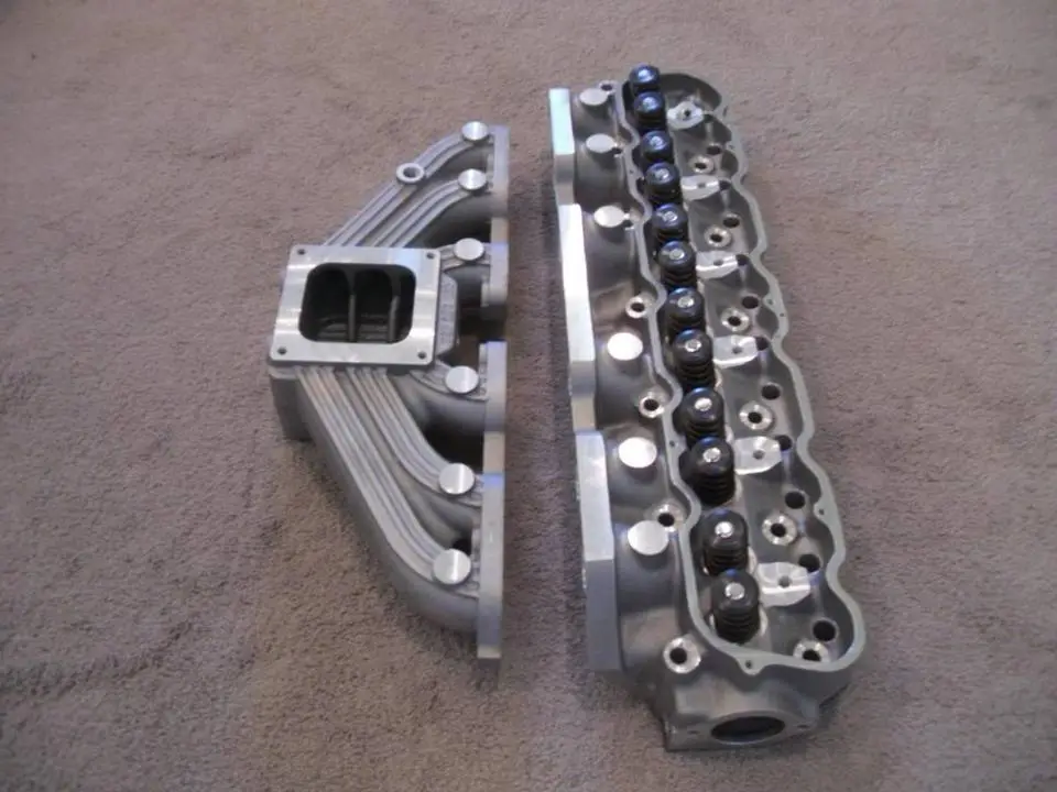

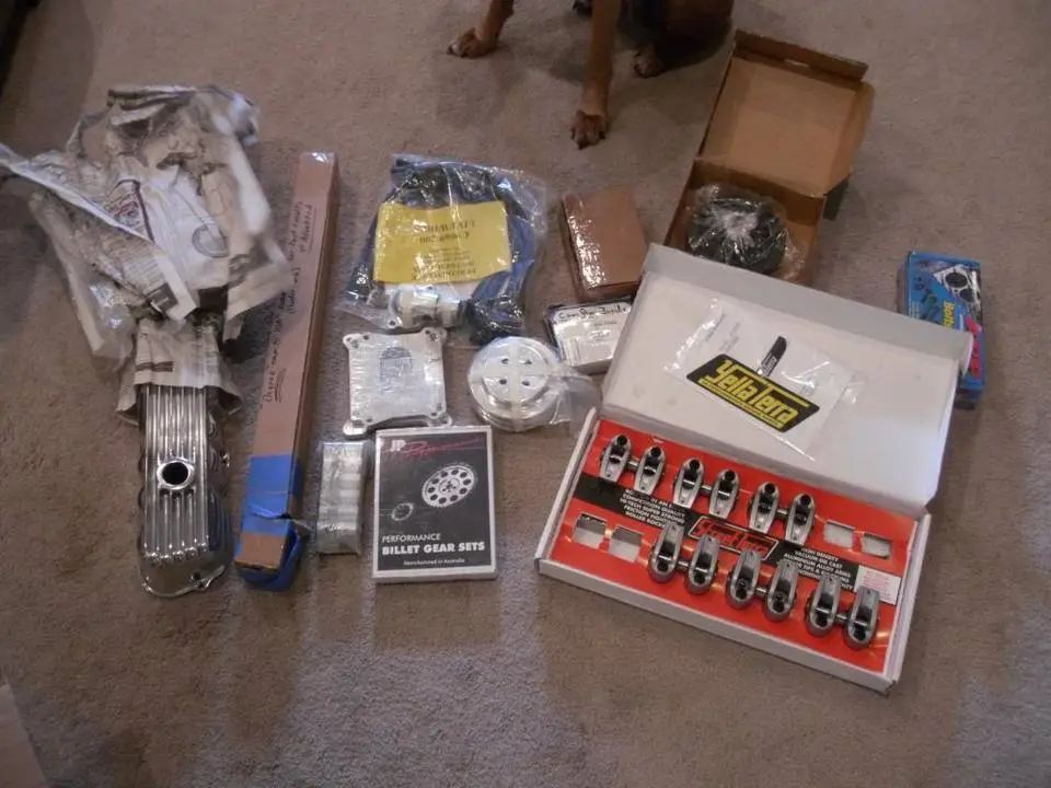

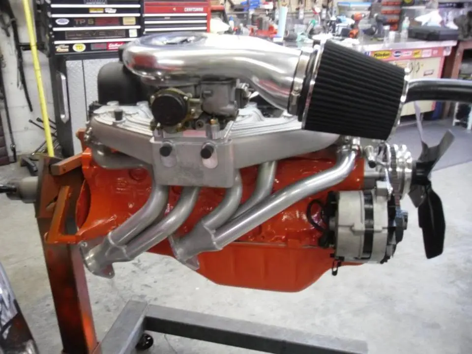

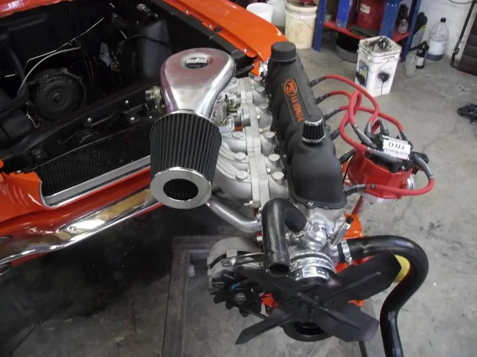

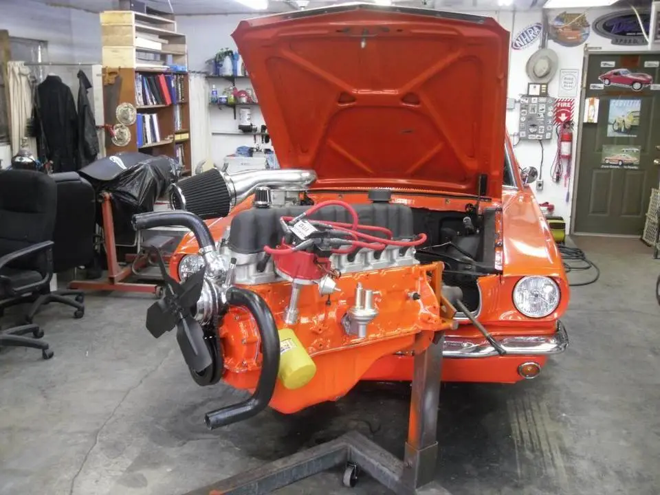

This is some pics of my I6 build. It has a Alum head from Classic Iines, 1.65 roller rockers, 264/264 110 clay smith cam, intake from Spectre, DUI and many parts from Summit. It will be dyno tested with the c4 and then a T5. Still have to finish it up waiting on pushrods and a few small parts.
Coolest project I've seen in a long time! Spectre makes that intake manifold? It's been several years since we sold my wife's '67 convertible with the 200 six, at that time the only good intake manifold was off of the Aussie 250. How much power are you expecting to make?

It is not going to me alot of HP but about 180 to 200 to the rear wheels. I just wanted to have something different and I can always turbo or super charge it later. It also will be a article in Mustang Monthly later this year.
by the way, clifford was supposedly designing an aluminum head for the small ford six for years, but it never materialized until mike at classicinlines.com took up the challenge and got one done.
HUGE six banger fan here obviously, love how clean yours is. Love the garage too, dang how I wish I could keep mine as nice!!! Keep it goin, let us know what she puts down and dont worry if the numbers are low, mine with a simple big log head, holley 2 barrel and dual out header was a ton of fun to drive for what it was, especially with the T5. Now with the turbo its SILLY!
