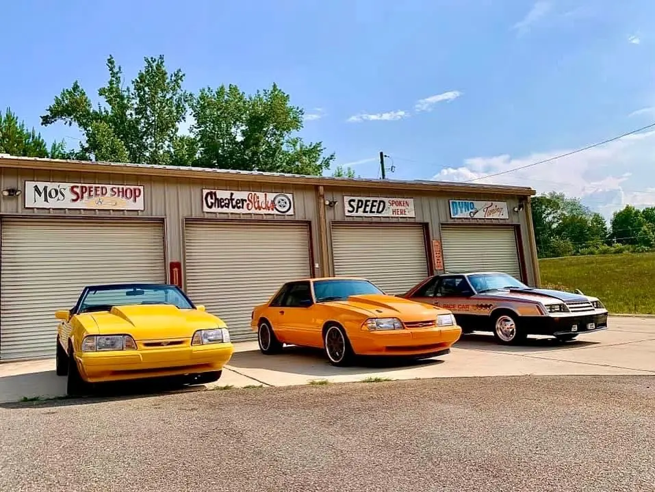

I'm pretty sure Mo's would work well for you, they're a little closer to you being in Dallas. Their website is down, but here's their FB page.
I can't speak from any kind of experience with their services, but they have a dyno and I believe they host a Fox Mustang show regularly.
