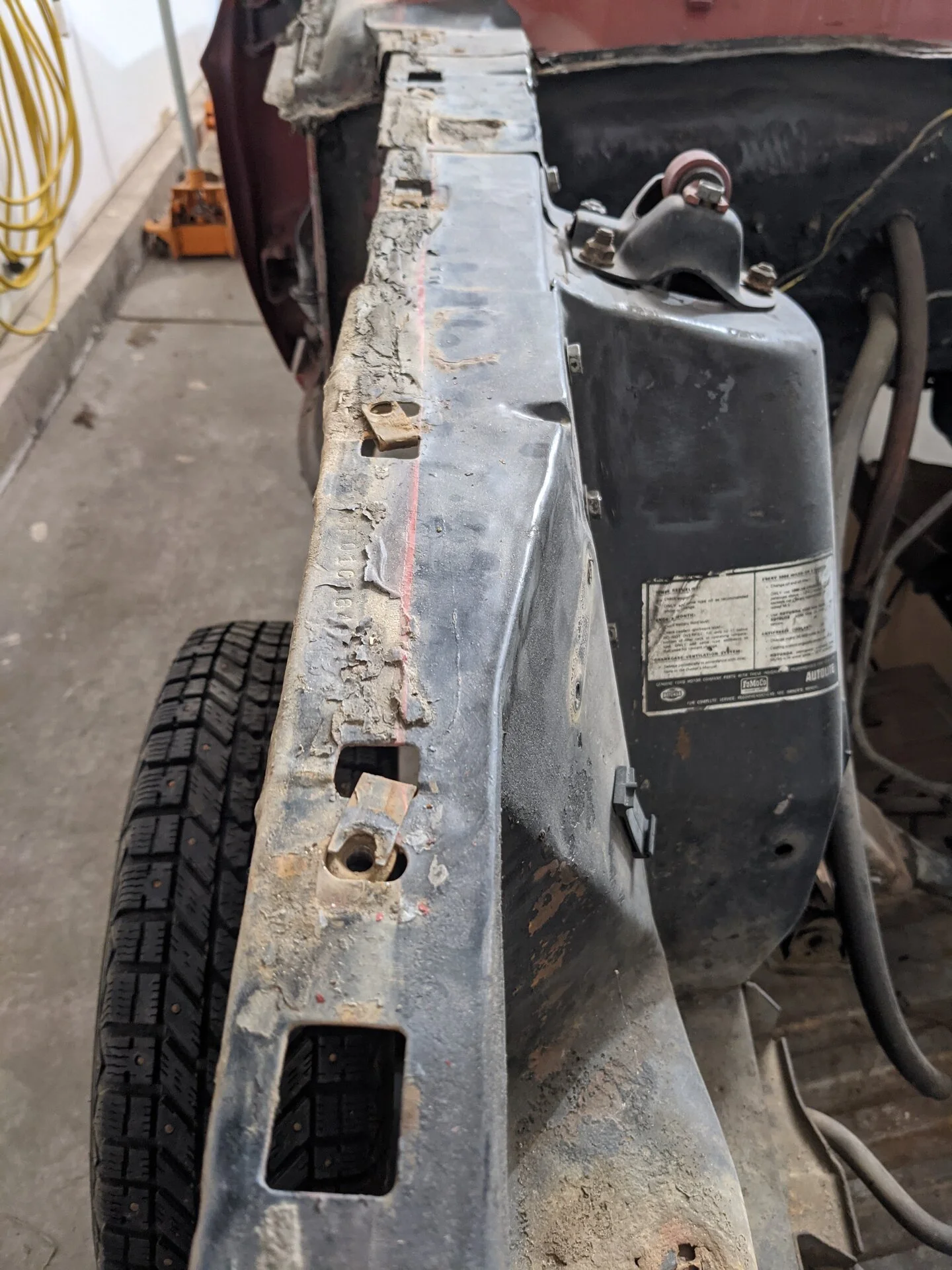

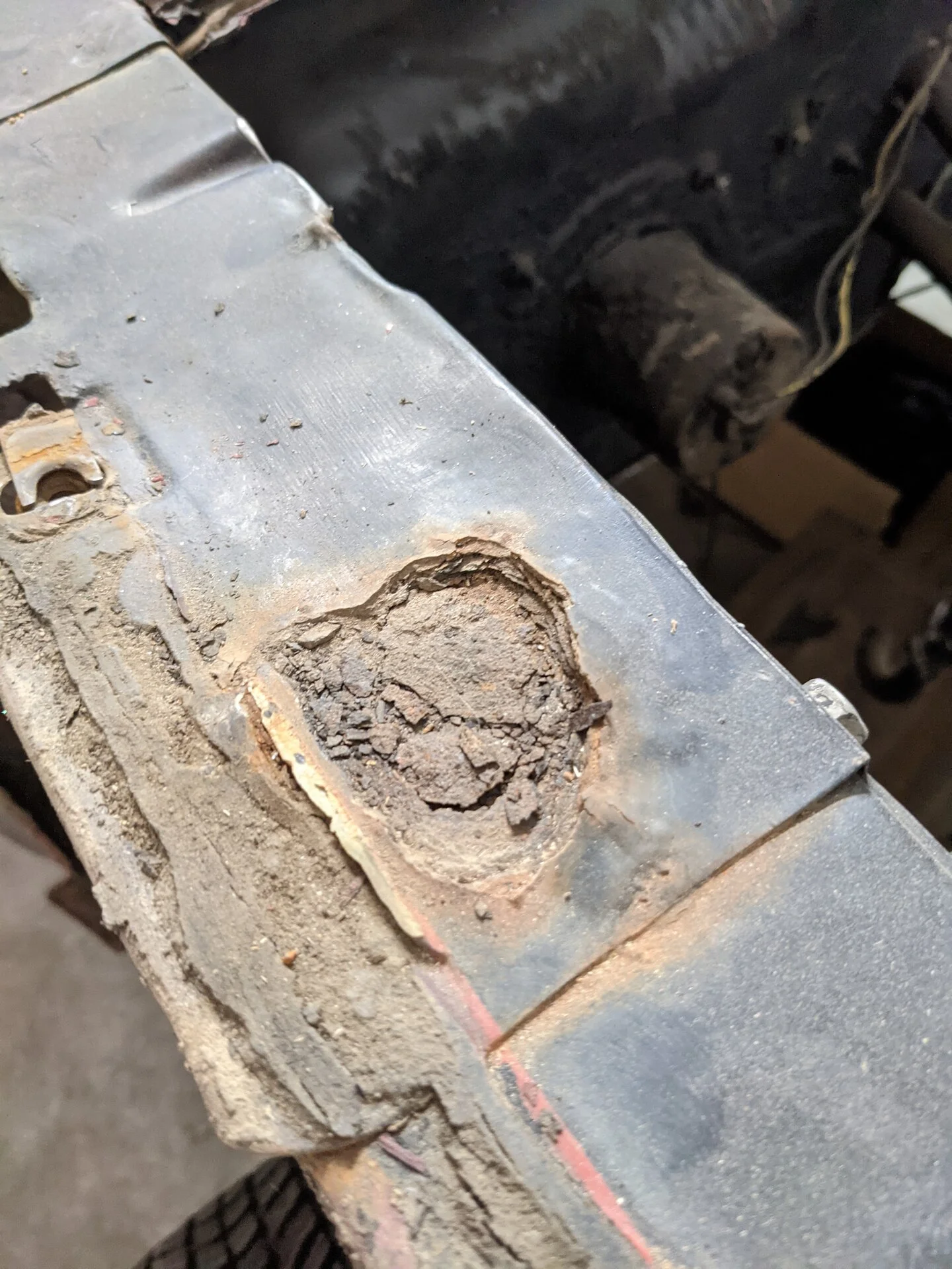

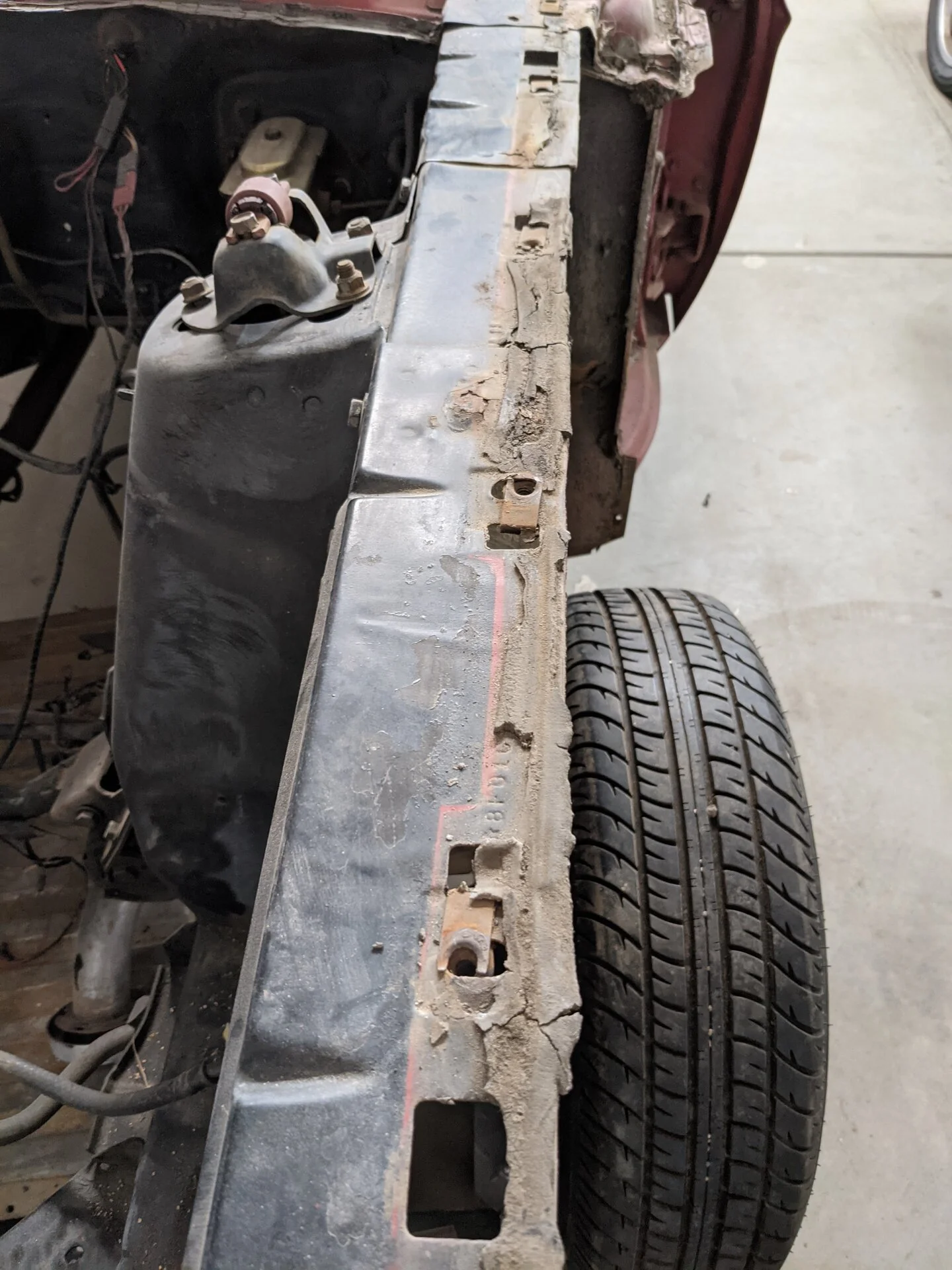

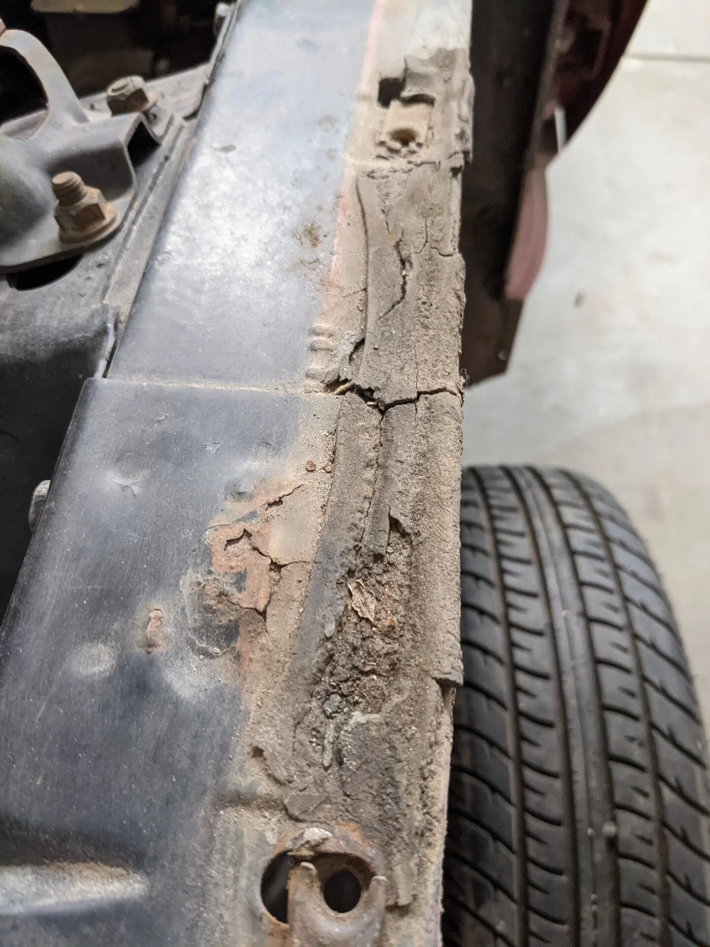

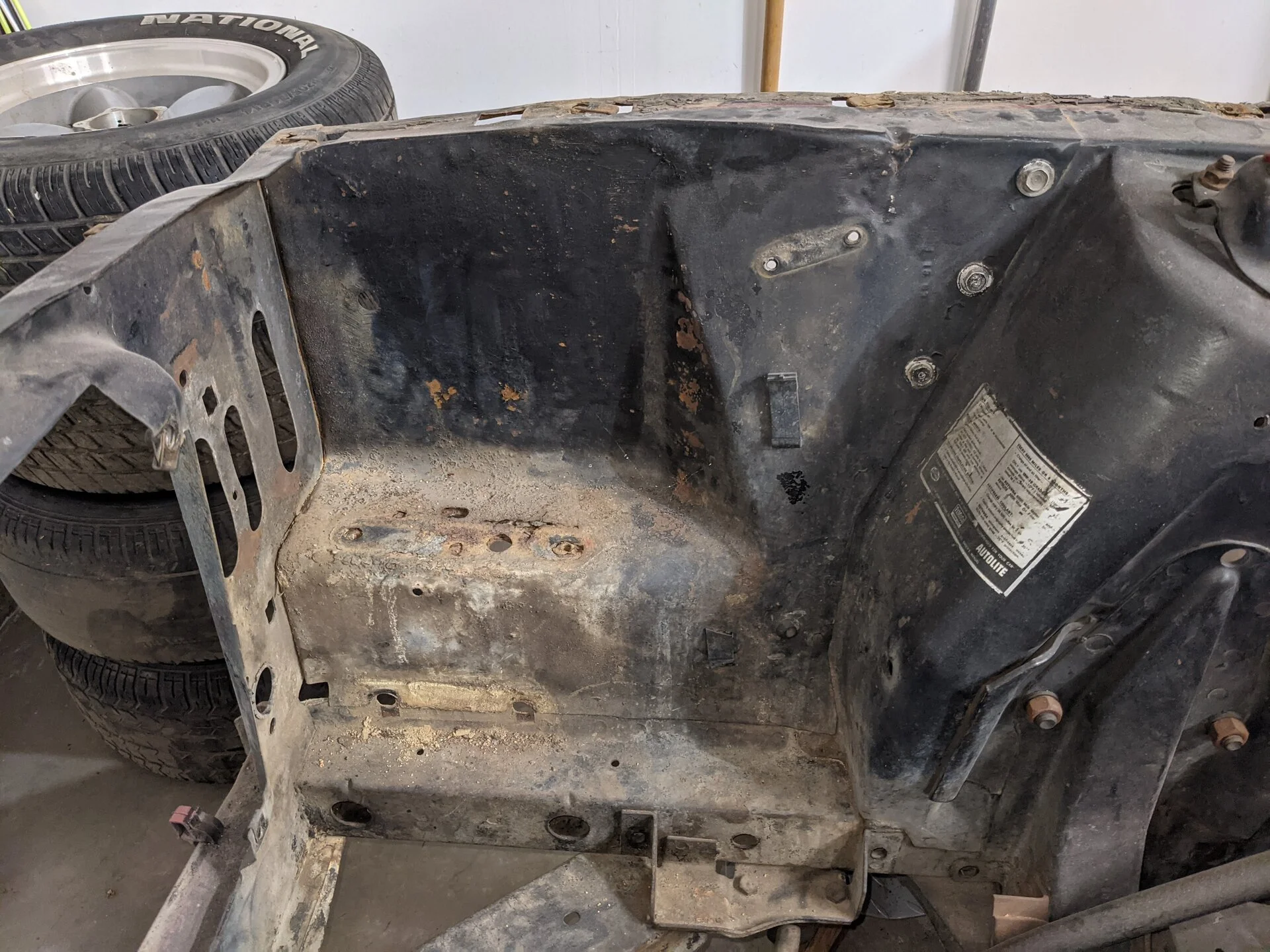

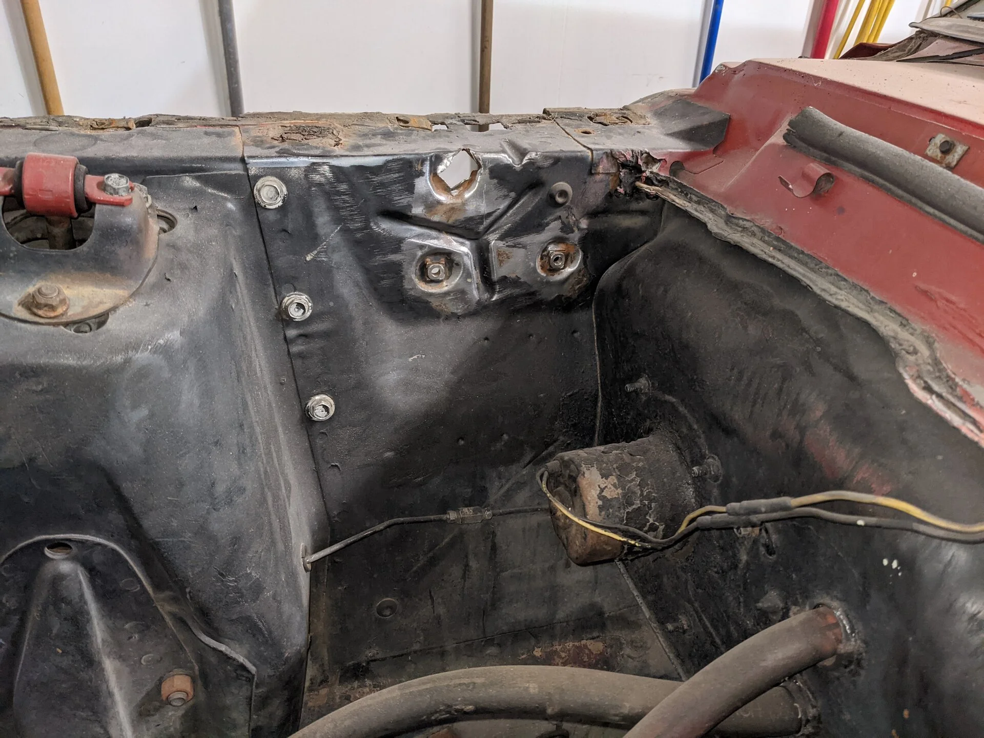

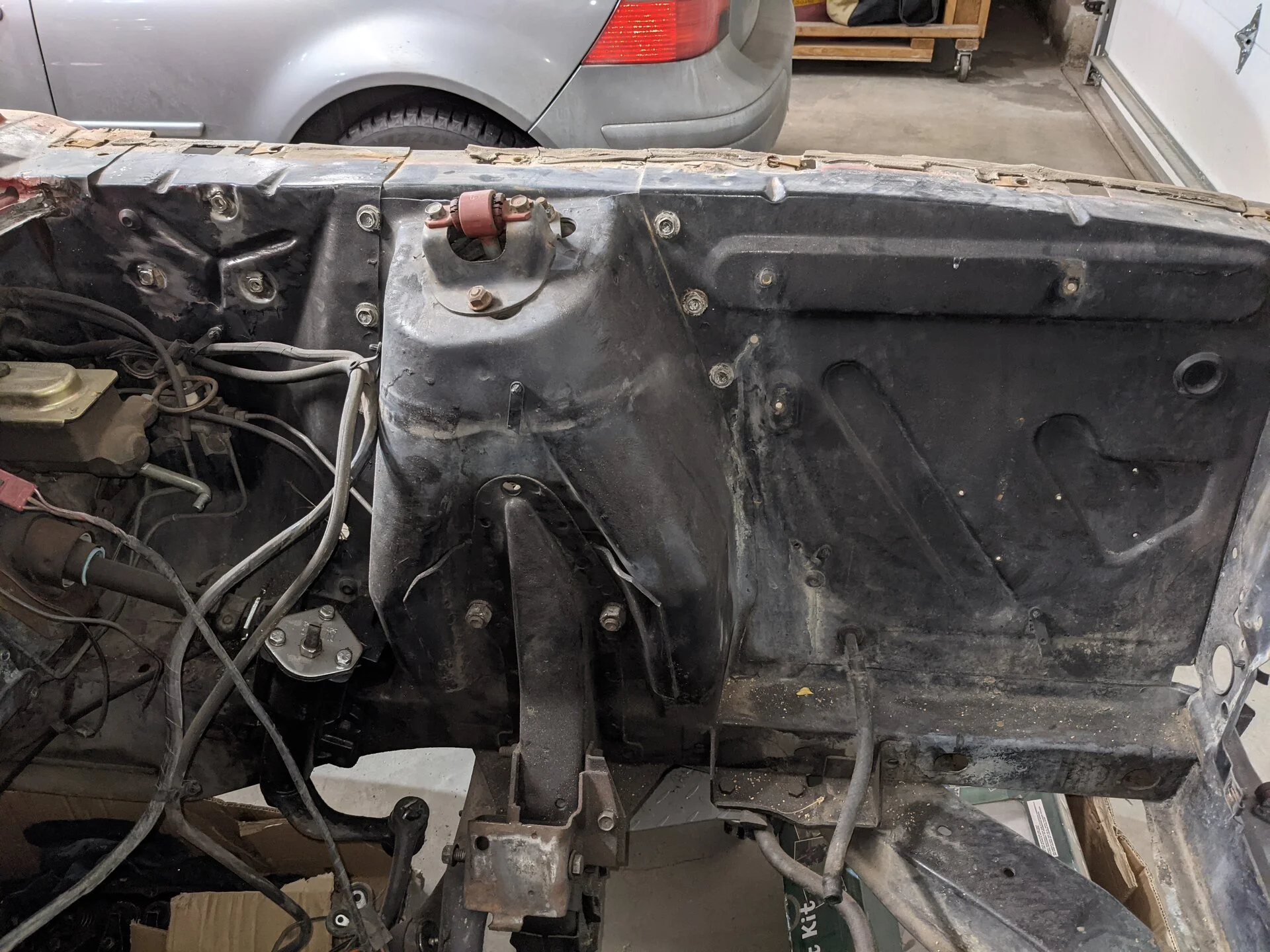

My inner fenders could use some attention. The front passenger section has the common battery corrosion and the rear passenger section had a hood hinge partially ripped out when the hood flew up. In addition to that, the tops of the inner fenders have some rust, definitely worse on the passenger side than the drivers.
I have all 4 new sections and have contacted a shop in my area. They quoted me $100 an hour and guessed I would be looking at 3ish hours per panel. At the very least, I would like to get the passenger side done but may also get the drivers. Is this a fair quote? I do not have a welder or any welding experience myself. If the task is super easy, I wouldn't be opposed to spending the money on buying myself a welder instead but assume I would need some good practice before diving in on the inner fenders.
What about the vin stamps, should I make sure they are cut out and weld back in?
I plan to remove paint from the engine bay and prime and paint after having the inner fenders repaired.

this is just me, but before i paid anyone anything, i would strip those areas down to bare metal and see how it looks. metal expands a ton when it rusts and looks worse than it is. it's possible these areas can be saved and you only need a little metal work and a bolt hole fixed.

It all comes down to what you wanna do and what you wanna spend. I personally would use the money to buy a nice compressor and a second hand welder. This is after I stripped the areas to find out how bad it is or is not.

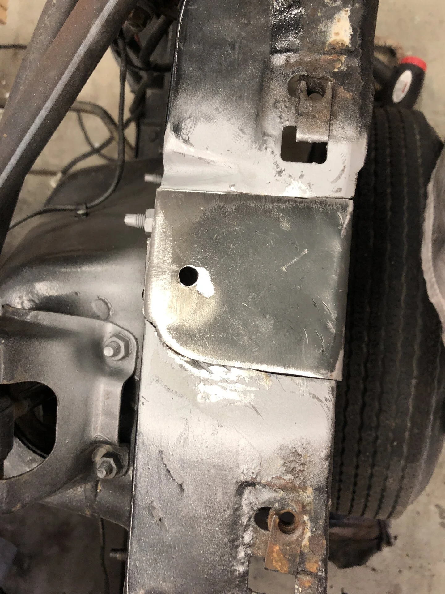

Those don’t look too bad really. I had fenders much worse than those. I bought a HF mig welder and repaired the fenders myself. The welder, accessories, and sheet metal was about $300 total. I taught myself how to do it with online videos and some scrap metal. The final outcome was not concours ready but I am happy with it.
