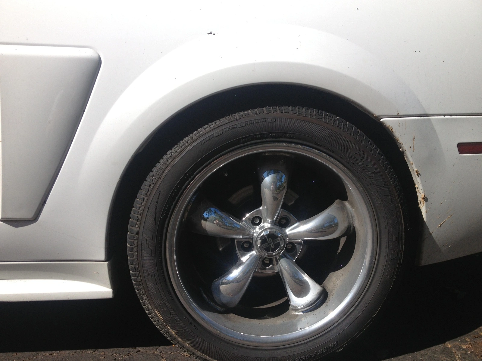

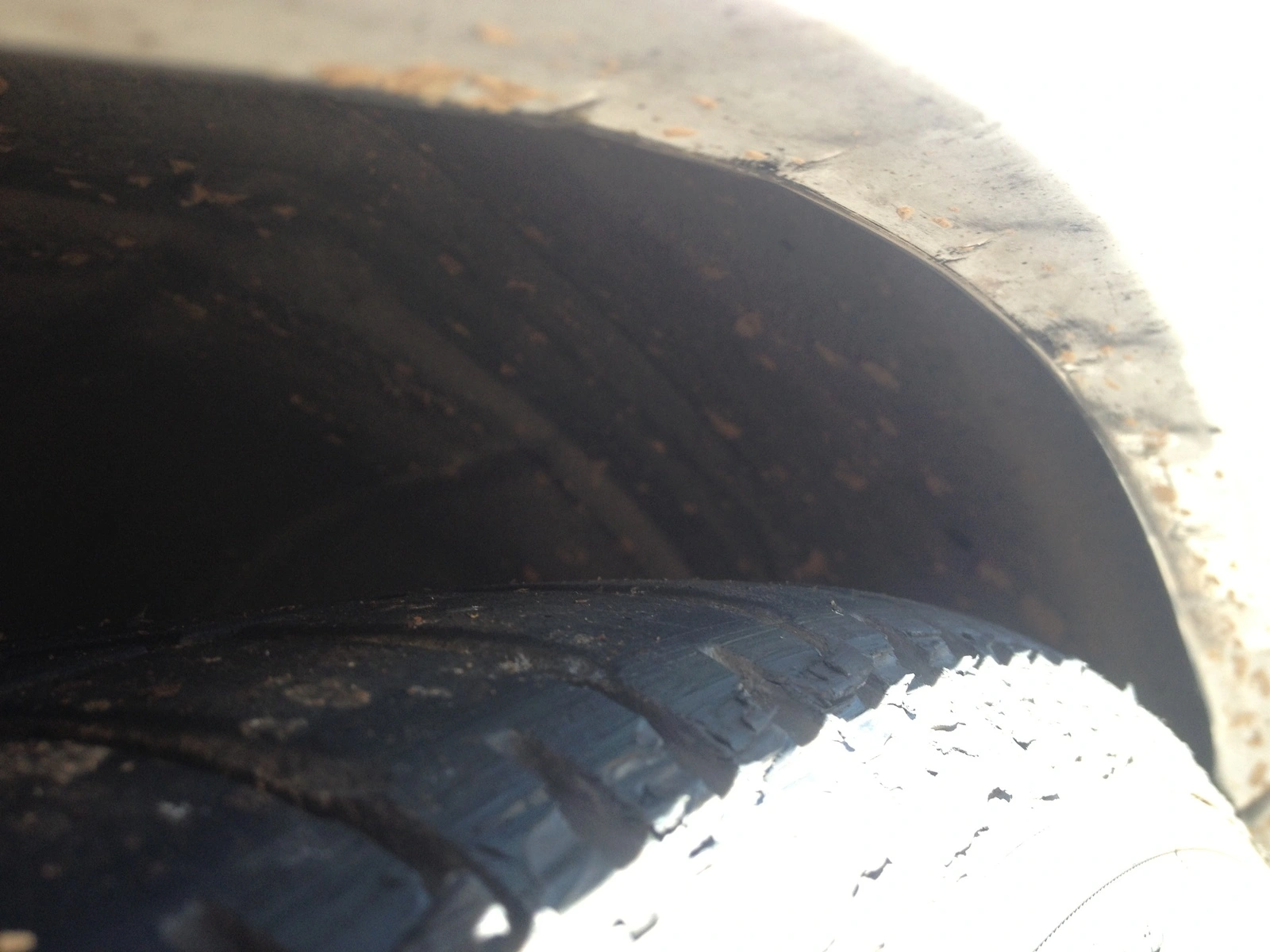

Here are the pics that were requested.

No wheel spacers and I have no clue what the off set is. The wheels were on the car when I bought it. I think I'm going to replace the control arms, and put different shocks on it.
Judging by the pictures, it doesn't look like its too low or the tire/wheel combo is too large. It is obvious that the inner fender lip is eating up those tires though. Maybe it is the control arm bushings. Got a head scratcher there.
