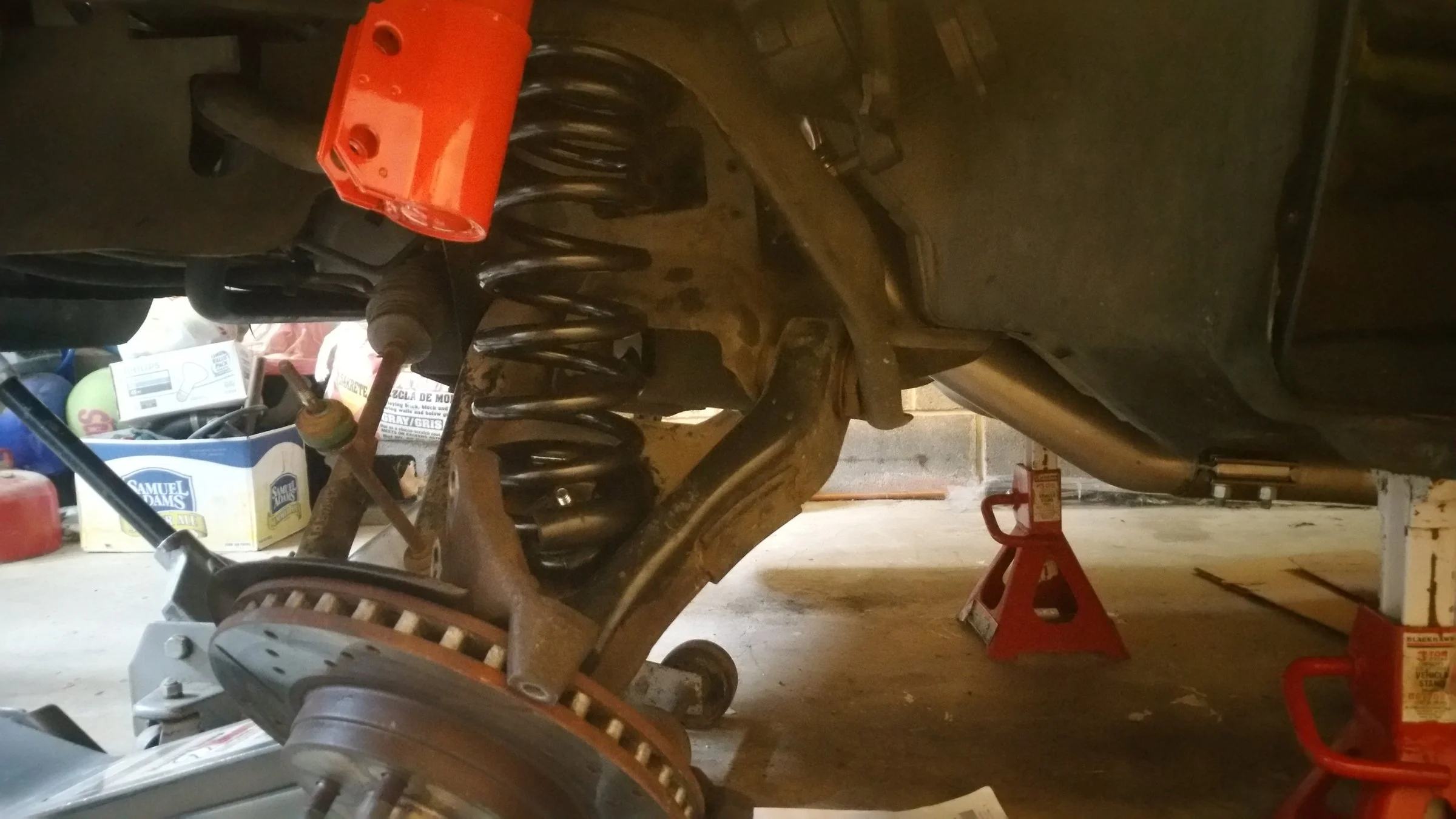

Hose Clamps
Not pretty and I certainly was concerned. but it worked! Now just waiting for the springs to "settle" before getting it aligned and sub frames conectors welded in.
Front has set a nice height... hoping the back will drop a bit more.

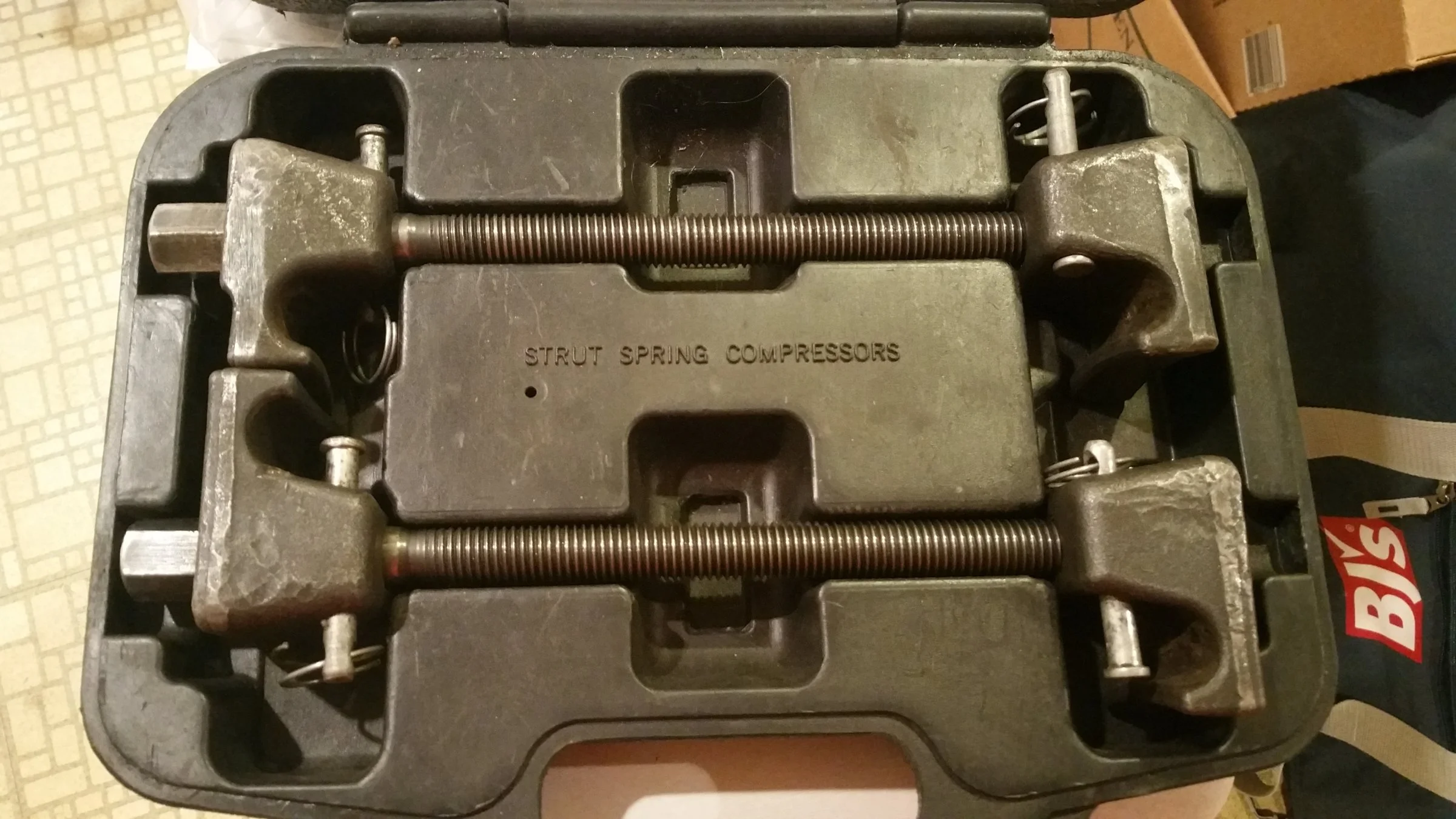

I literally did Eibach pros this weekend, I hacked up a spring compressor so it was short enough to fit between the control arm and upper perch. Used the Maximum motorsports spring tool to hold the bottom of the spring from sliding out while raising the control arm, also installed MM cc plates. It was a HUGE pain in the ass but the other side went in very quickly after I shortened the spring compressor
