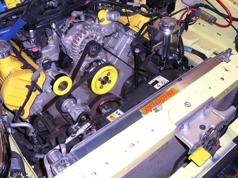

I had my sensor located there but always felt the temps I got from that location were a little hi due to the poor flow in that area and those cylinders typically running hotter the the others. So here's what I did When I installed the Fuidyne last summer. And now the gauge shows fluctuation as the thermostat opens and closes which you don't get with it mounted in the block.
Look at the thermostat housing.

How do you get the hole in the housing to be perfectly level? Or do you just eyeball it?
I don't think it needs to be level. It should be close to the bottom on the T-stat though (not at the top)
