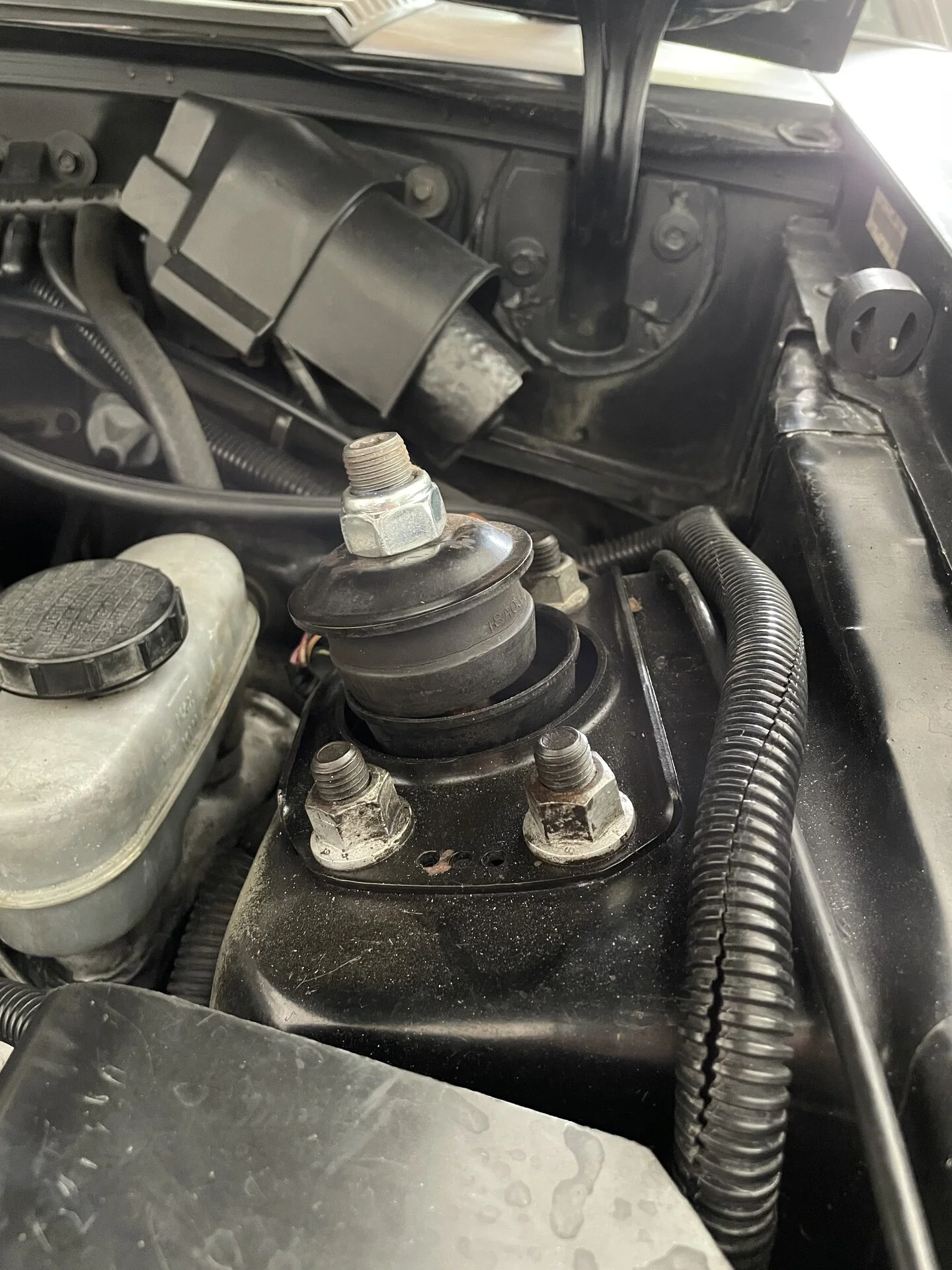

Installed B6’s up front, used factory lower bump stop and upper bushing (no dust boot needed for these). They seem to be sitting…high. Did I’d do somehow wrong?

yeah that doesn't look right. The top and bottom bushing should be tight in the camber plate. That gap shouldn't exist. What is the weight resting on?
