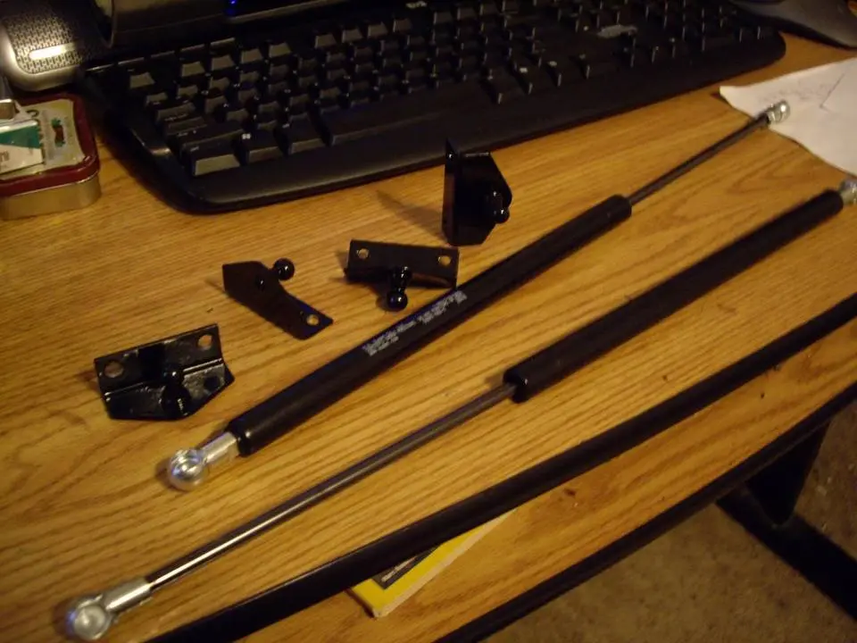

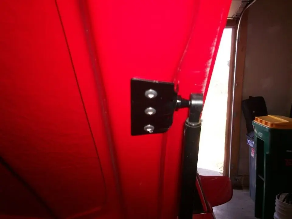

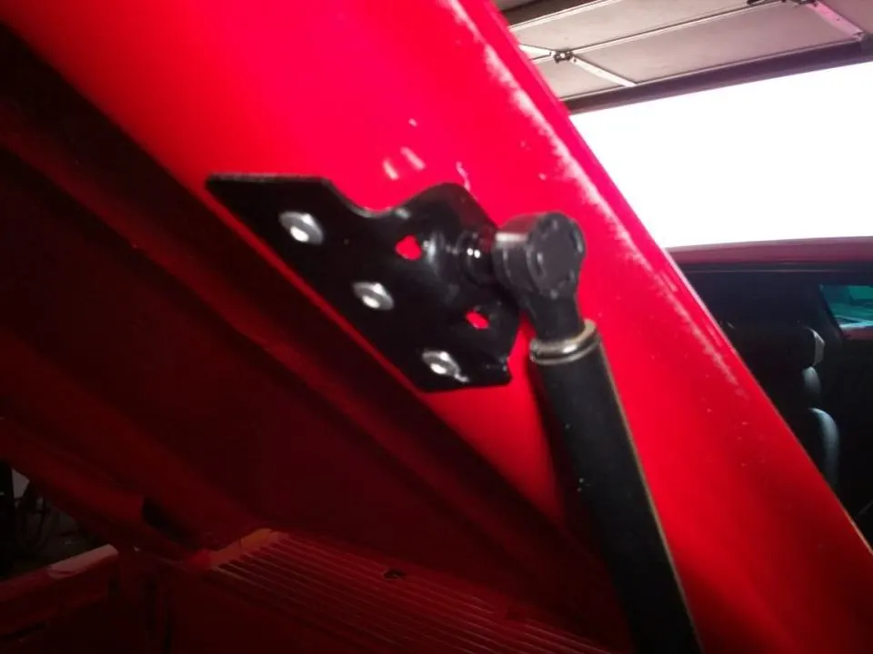

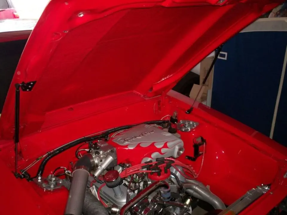

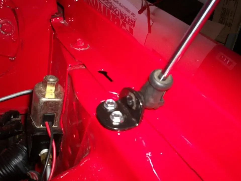

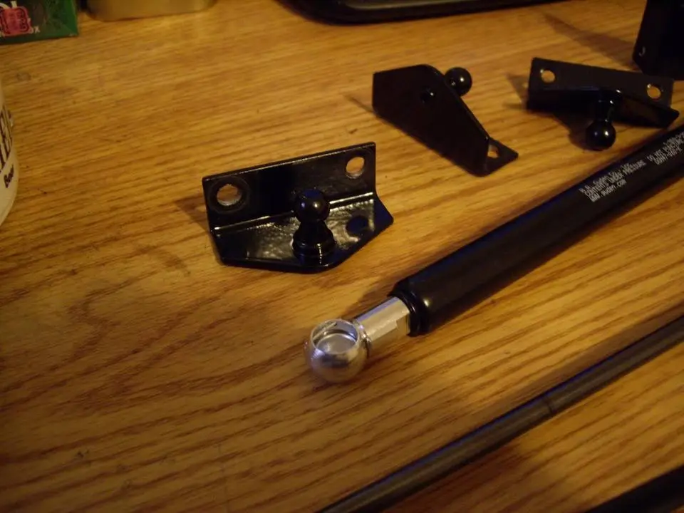

I decided to install a set of hood struts on my Mustang instead of dealing with the pain in the ass hood rod! I looked at the price, and they wanted close to 100 bucks for the set. So I decided to make my own! I went to the junk yard and used the hood brackets from a Grand Prix, the fender bracket from a Kia, and the struts are from an Intrepid....lol I had to modify the hood brackets by cutting them shorter, and drilling new holes! This only cost me $17.00 and a couple hours of my time. How do you think it looks?

Nice! I just ordered a set on the bay for $50 cause they dont require me to drill but for $17 I woulda been all over that

Looks pretty neat.

looks like a clean installation man, nice can't beat that with a stick for $17!!

Looks as nice as any of the kits i've seen. What year Kia? I've been thinking about doing the same but i figured it would be more hassle than that.

NOW THAT, is one clean ass engine bay.

The bottom brackets came off of a full size Kia, can't remember what the hell it was called? The top brackets were off of a mid 90's Grand Prix, and the struts were off of a 01 Intrepid! I just searched the junk yard for a bit, and when I found what I needed I test fit them on a Mustang in the Junk Yard.
