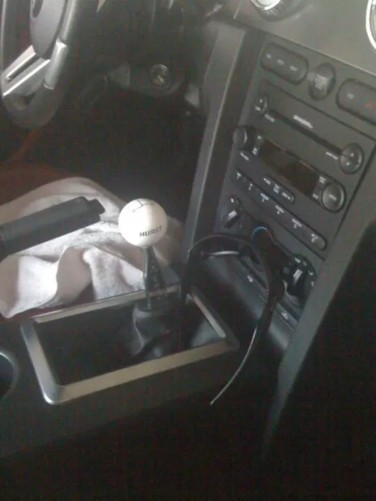

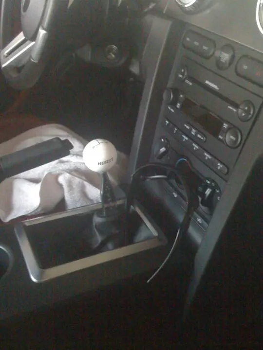

Well I got it installed! It looks and shifts great! I couldn't locate any single Dynamat pieces. The only way I could get one was to buy A huge package of them for $100:nonono: I'm certainly not going to do that! The only rattle that the shifter makes is when I'm downshifting into 3rd from a high rpm. I can live with it. I love that tight, tough shift it has. reminds me of my 72 Nova I had in high school. I like my Stang much better than the Nova! Thanks Diesel for helping me choose the right shifter!
mine.....
my neighbors....

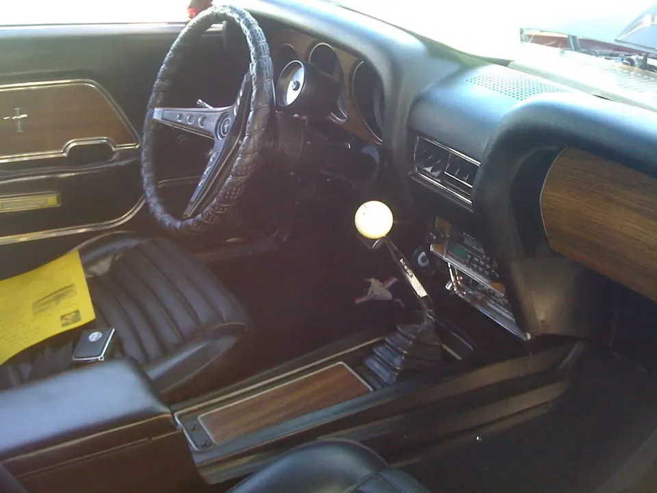

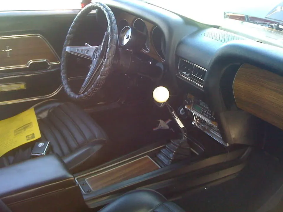

What is your neighbors? A 69?
yep 69 Mach 1. I'm trying to get him to put headers and a decent exhaust on it. He wont budge because he's an originality freak. It's a Windsor motor with original carb, points ignition, etc. I want to buy it, but he won't sell it.:(

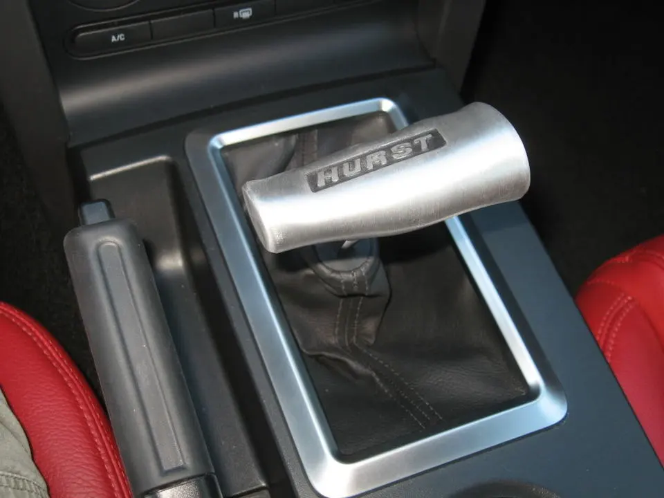

I found a stylish $10 fix for the Hurst rattle.......
The Hurst T handle with brushed finish seems to stop the shifter rattle....
It's on Ebay for $10 a pop. IMO it feels better than the ball. The brushed finish even matches the boot trim ring on the console. The seller on ebay is rebelperformance. This handle retails for over $30. He's also selling the whole shifter assembly for $150 w/free shipping.
