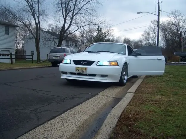

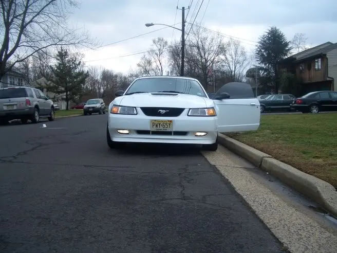

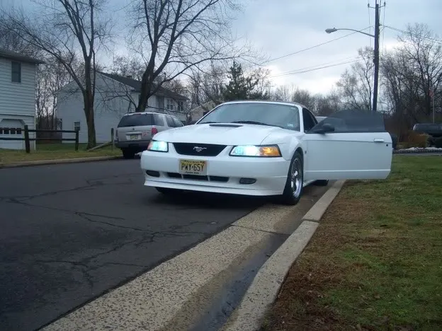

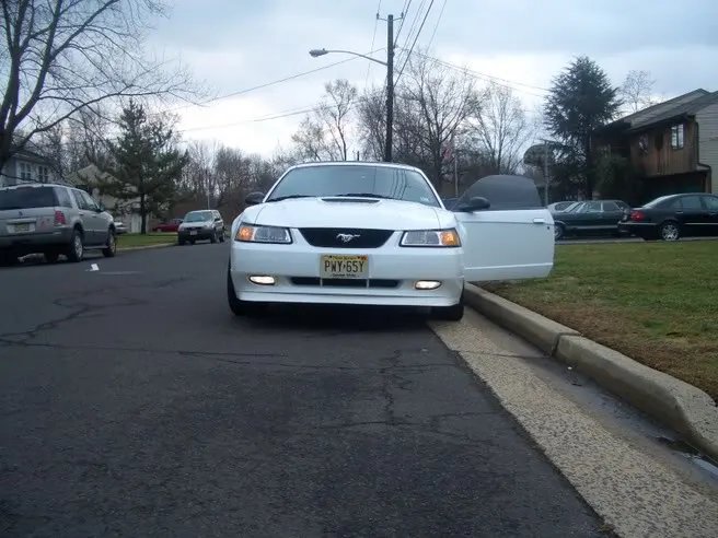

I finally got my 6000K HIDs on Christmas and I couldn't wait to get these suckers in. Recently while driving around in my dads Infiniti with HIDs I realized how HORRIBLE my vision is at night (even with Silverstars).
So I asked for a 6000k kit for xmas and I threw them in today. The install took about 25 minutes and I went in not knowing a damn thing. You simply keep everything stock and all of the harnesses tuck under your air filter and behind your battery. Everything else stays stock and the ballasts connect directly to your battery terminals. It's brainless and easy as cake. Anyone can do it. If you have any questions about the install, please ask.
I didn't take a before shot but I have some after shots. For some reason though, now when the headlights are on, the fogs turn themselves off. I'm not complaining though because when I had just 1 HID in the fogs stayed on and the brightness comparison looked rediculous. So I was going to turn the fogs off everytime I had the HIDs on. I think my car just knew what I wanted.
Anyway, the pictures do no justice to how they really look. They are sickingly bright and I will be expecting some flashes this night when I'm driving around.
