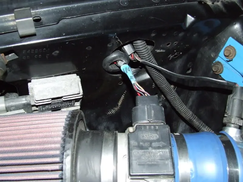

here is what i moved around, the major object being the motorcraft thing. i also put all the wires into the fender. im 100% they are all connected
