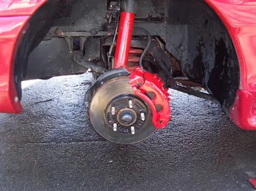

My problem was is that i had spongy brake pedal (or whatever you spell that) I always change front and rear brake pads with new one from AutoZone but same thing, i have good caipers all way around but nothing, so i try bleed brake fluid with syntetic Valvoline ,so before i bleed brakes i tested 60-0mph and i got 187ft (factory specs are 150ft) thats 37ft more than factory, so i bleed brakes and i tested again and i got wooping 152ft DANG thats just from bleeding brakes, oil was black and i thing thats factory 11 year old oil, i had no air in system but i thing i had moisture, so last weekend i installed PBR front calipers with brake pads from AutoZone (cheap, $24) i bleed front brakes little bit more and last night i tested again 60-0mph and i got 127ft :banana: ,thats more i have expected , don't forget i have heavy a$$ convertible with speaker box and everything , its street wight over 4000lbs and i still have cheap brake pads from AutoZone so there is more if i get performance pads or even sloted rotors

Here is my new PBR calipers

Do the PBR calipers just bolt up to the stock brackets? Would i need a different rotor size? And will they clear my Waffles?

PBR calipers will bolt on spindle with little bit griding about 5mm ,99+ Mustangs use same rotors like 94-98s
Here is the link for better explain http://sn95brakes.cjb.net
