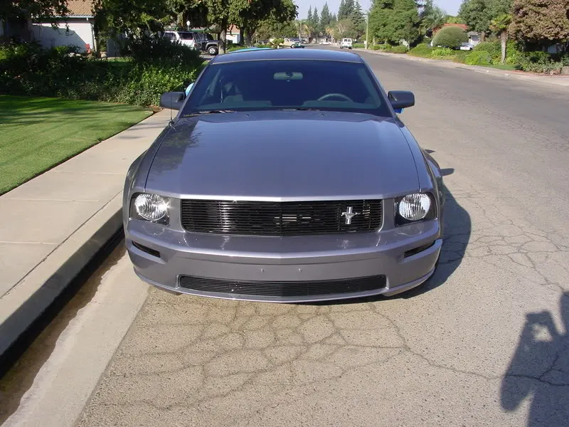

I replaced mine with the Street Scene Black Chrome upper and lowers....I hated the plastic look.

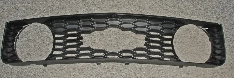

Some grills, like the shelby insert require you leave the stocker in and modify it to fit.
You can see it hidden in the back of mine.

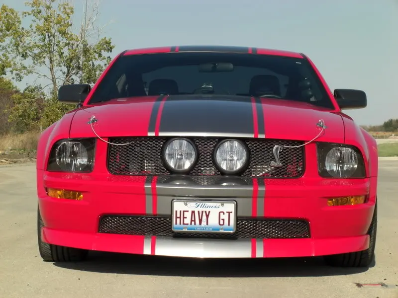

To modify your exsiting grill it just takes patience with a dremel, and it will turn out like this:
Overall, the grill installation wasn't that bad. Getting the stocker out is the hardest part. If you are the slightest bit mechanically inclined then you'll figure it out.

was it easy or hard and where did u buy it?
i see u relocated the fog lights, looks nice
pretty easy to install...the OEM grills are just attached with clips and the top one uses the same OEM style clips. The fog lights were removed and unclipped. I used the supplied extenders to move the Fog lights to the center. For the bottom grill...had to take the OEM grill out to attach the new one as it fits inside OEM one.
