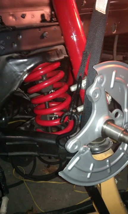

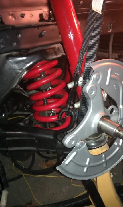

i will be doing this in about half hour with about 4 friends here is where i am right now
well after we were done i realized that my friend didn't have the springs in the correct spot between the holes.i was jacking them up while he used a prybar to hold them in place.frustrated i decided to go with the maximum motorsports part that holds the spring in place .i looked on the website and i couldn't see spending 22 dollars on something that i felt i could make .i also was very impatient and wanted to get this thing back on all fours.this is very dangerous and by all means i recommend buying this tool from them because it does make the job much easier and safer.i made my own but alittle different i welded a bolt and used a pulley on the bottom to hold it in place underneath the control arm.it worked like a charm here is a pic of what i did you might be a redneck if lol again i don't condone anyone doing this at home please buy the tool from maximum motorsports
