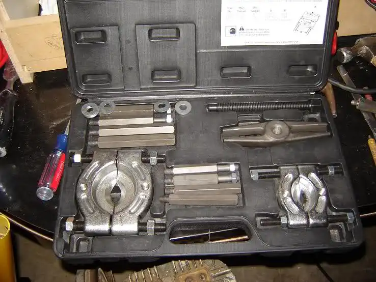

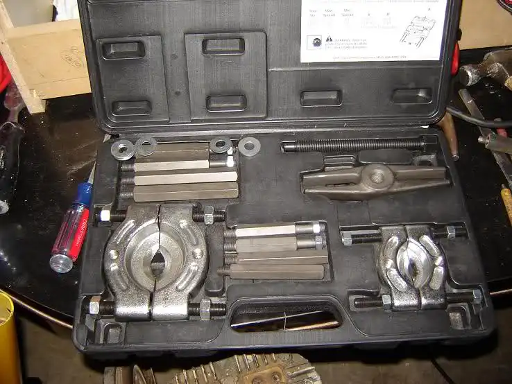

alright here are soem special tools that i have to make it more easier this is my bearing puller kit
