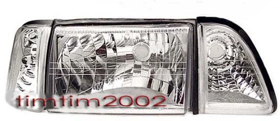

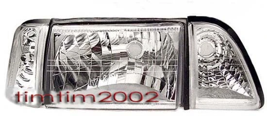

Anything i should know before installing?? Any tips or tricks would be helpfull. Thanks.
I'll be putting these on this w/e.

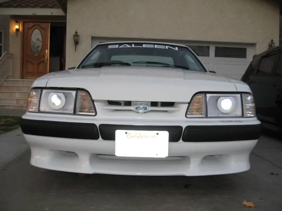

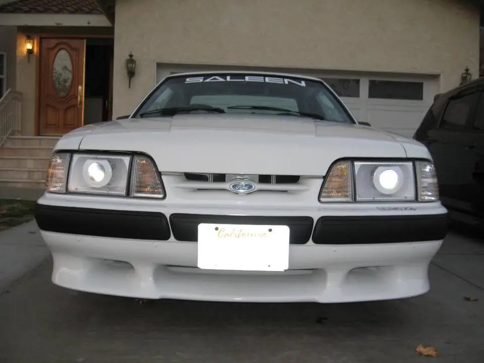

StangCrazy302Gt said:
speaking of hid's how are then in a fox, cauz the stock lights suck
well i can say with a hid retrofit it's great. i'm sure there's a lotta glare with drop in bulbs.
