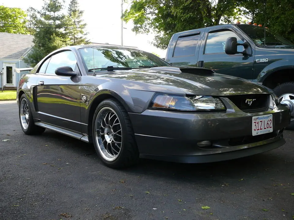

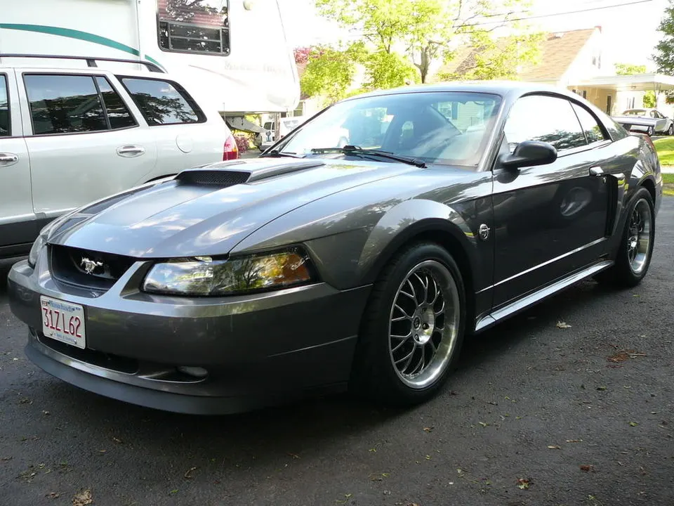

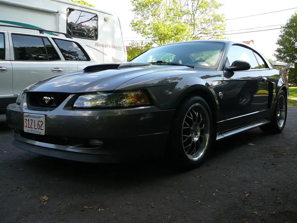

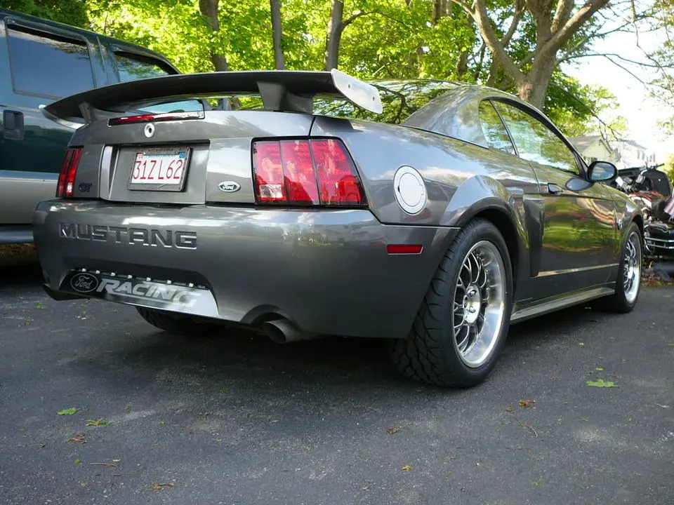

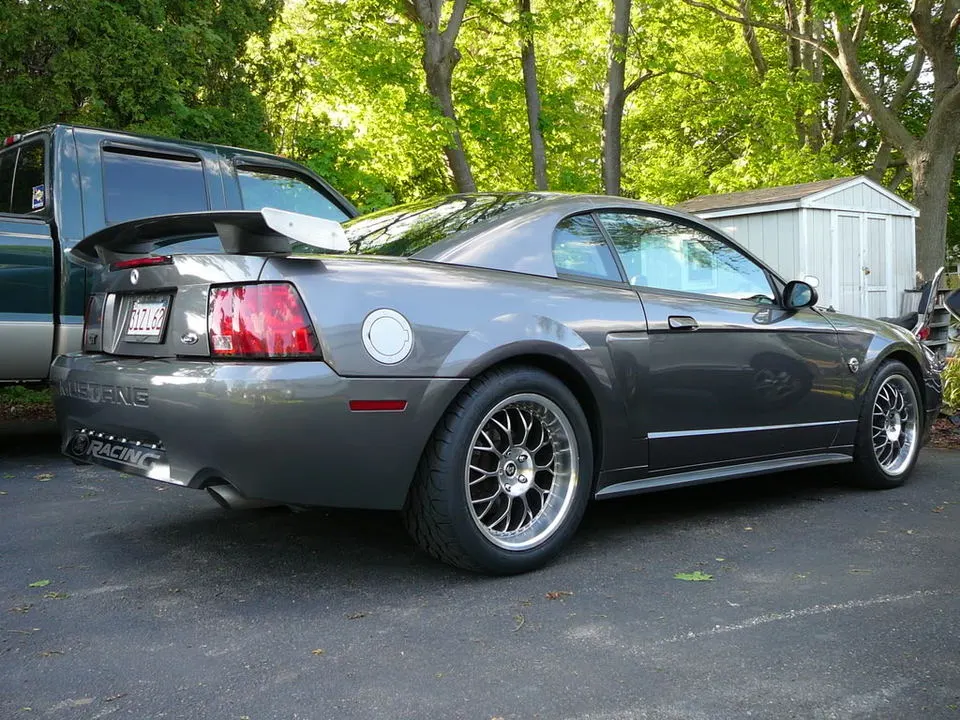

Jbauer: Here's some pics from another thread I made. They fit perfect. It's tough to guess the fender gap now, mostly because of the offset of the rear wheels and the 9.5" width vs most guys running 10". Overall, I like 'em alot, the ride quality with my other mods in the sig is suprisingly civil, and with my particular tires, the grip is like nothing I've experienced in 6 years of Stang-ing. I plan on getting some 1/2" spacers for the back to flesh it out a tad in the fenderwell, but even then, they already look perfect with the fronts stagger-wise, they just look smaller than they are because they sit inside the fender some.

The fender gap actually looks a bit exaggerated in those pics vs. in person. I did gain a little extra rake from them, but isn't that the idea with these cars anyway :nice: ? I am also running energy suspension urethane spring isolators all around, top and bottom, so even with my BBK springs, it still looks a bit up in the air. Like I said, it's not as bad in person, and I'll take the tad extra ground clearance. I tore a huge hole in my 87's prochamber one time on a rough road with the same springs and 245/45/17s. If I ever go to LT headers, I'll need it around here. I'm definitely happy with the look, because when I'm done, my car will have alot of "muscle car" influence to it, vs. some guys who have more of a "sports car/ speedster" look, like some Saleens and such. More brute, less lightspeed look to it than the 295+/35 tires guys put on 18x10s.
It would be tough to guess that for you Bauer, because my wheels have a strange offset. They aren't intended for a Stang, actually I found out after I fell in love with them that they are very popular amongs the import and BMW crouds (shhhh, don't tell anybody). So my wheels may sit a bit shallow for their size in the well. I'd say I have atleast 2" of fender gap, but because my wheels sit a bit inboard, they have more room to travel beyond the lip. I also run a stock pinion snubber with my setup just so that I run no change of bottoming out the tires in the fenders. I had that happen with 17x9s on my 87, and it sucked. I only notice the bigger snubber on huge bumps, because when it stops the travel that quick, you feel it. Otherwise, my springs/shocks/struts do a nice job of absorbing the roads around here, and I don't end up tapping it. Overall, I'd say that you'd want to run a larger tire width wise on an 18x10. You may end up with the tried and true 295/35/18 on back with a 265/35/18 in front. I saw that on a Mach with staggered Saleens recently, and it looked nice, just very "speedster."

Not at all. Especially when driving, because the suspension is so firm. Those shots are taken really low, so the car does look a bit "up" in the air. Also, my car was on a lift all day when those pics were taken, so the springs may have had to settle a bit again. I find mine do that any time they spend more than a couple hours on the lift.
