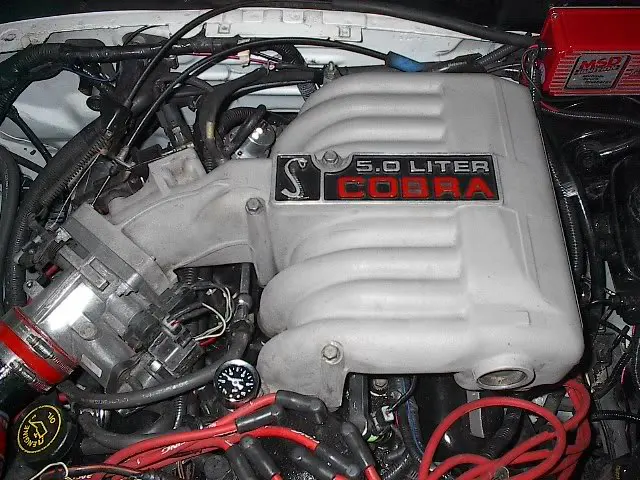

did mine when my fuel rails were out :D
DO NOT OVERTIGTHEN IT. I dunno why I felt the need but I put the hurk on it and broke the valve and half of it broke off in the connectors for the gauge..Still dont have me a guage that works yet. :( (haven't been able to/or tried to find the right size connections)
