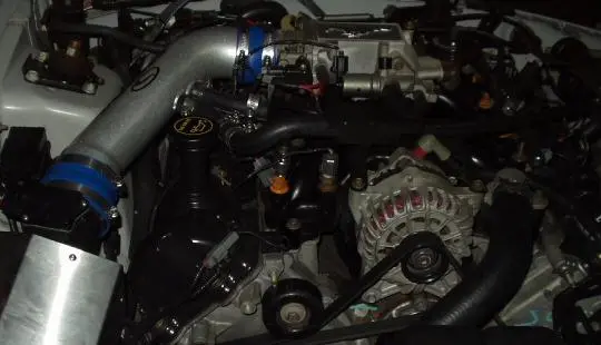

it will be listed in the instructions.
one thing i do recommend is the lil scew tight clamps, 5 of them to make sure the new hose connections are a secure (peace of mind)
