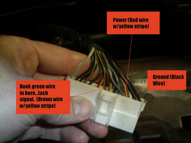

How hard is it to install a tach shift light on a 96 cobra. I know in my 2000gt I needed to bypass my computer. Do I need any special wire kits or do you just splice into my wiring system. Thanks for all the help.
Easy as pie...takes about 20 minutes...
That's if you get the raptor performance one. That's what I and a lot of guys/gals have. There's some others that are similar and someone will chime in about them, but I like this one the best.
You only have to tap 3 wires behind the gauge cluster.
