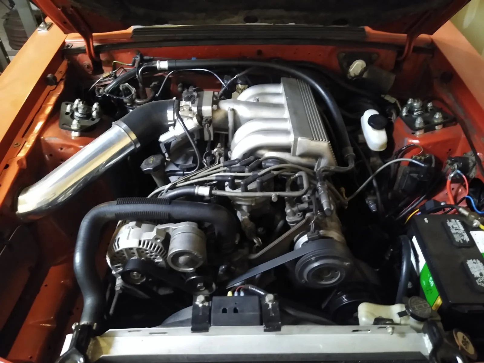

K&N Filter in fenderwell via home built intake. Keeps the intake charge nice and cool. The stock setup does a very good job of this as well.
The stock airbox setup is actually very good and was not a limiting factor at my power levels. I swapped to this setup simply to clean up the engine bay.
From my experiences with a speed density setup, if you're making under 300whp the stock intake w/o silencer isn't holding you back or costing you any hp.
I've dyno'd this car with both setups.

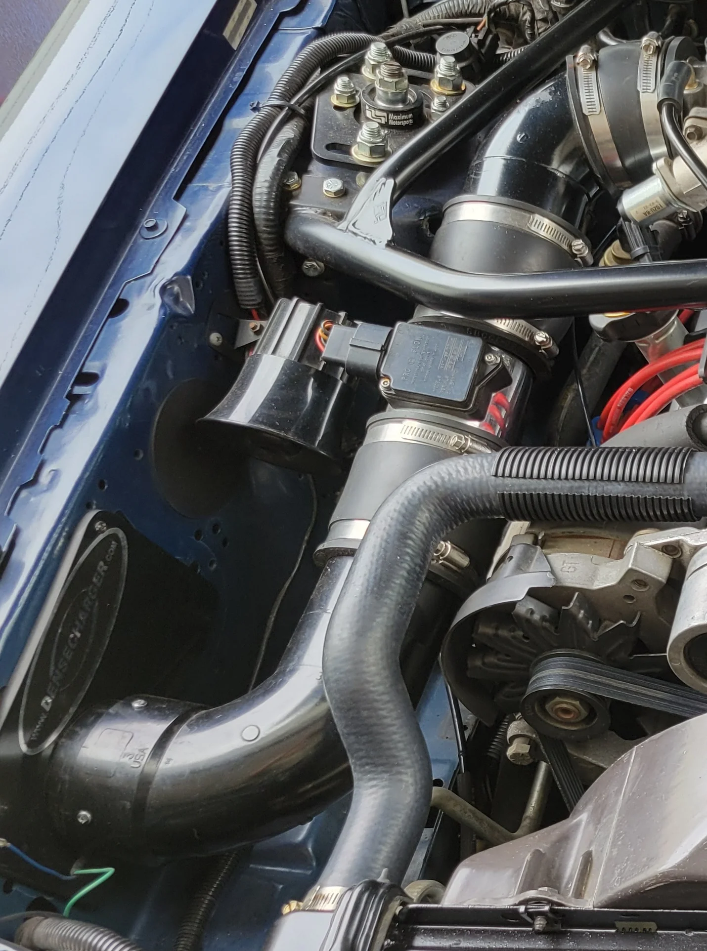

If you're interested in a CAI, I have a Densecharger one that I had to remove due to no CARB cert here in California. Nothing wrong with it, but bought a BBK one so as it passed smog. As all say, engine bay gets to hot.

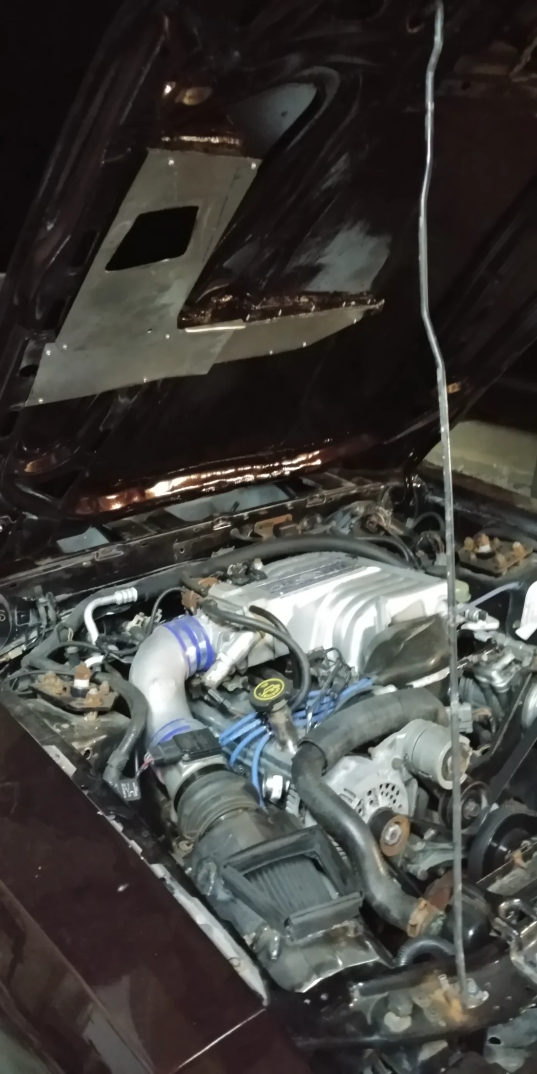

Stock air box (which pulls air from the fender not the bay) or in the fender filter kit. Otherwise you don't have a cold air kit, you have a hot air kit.

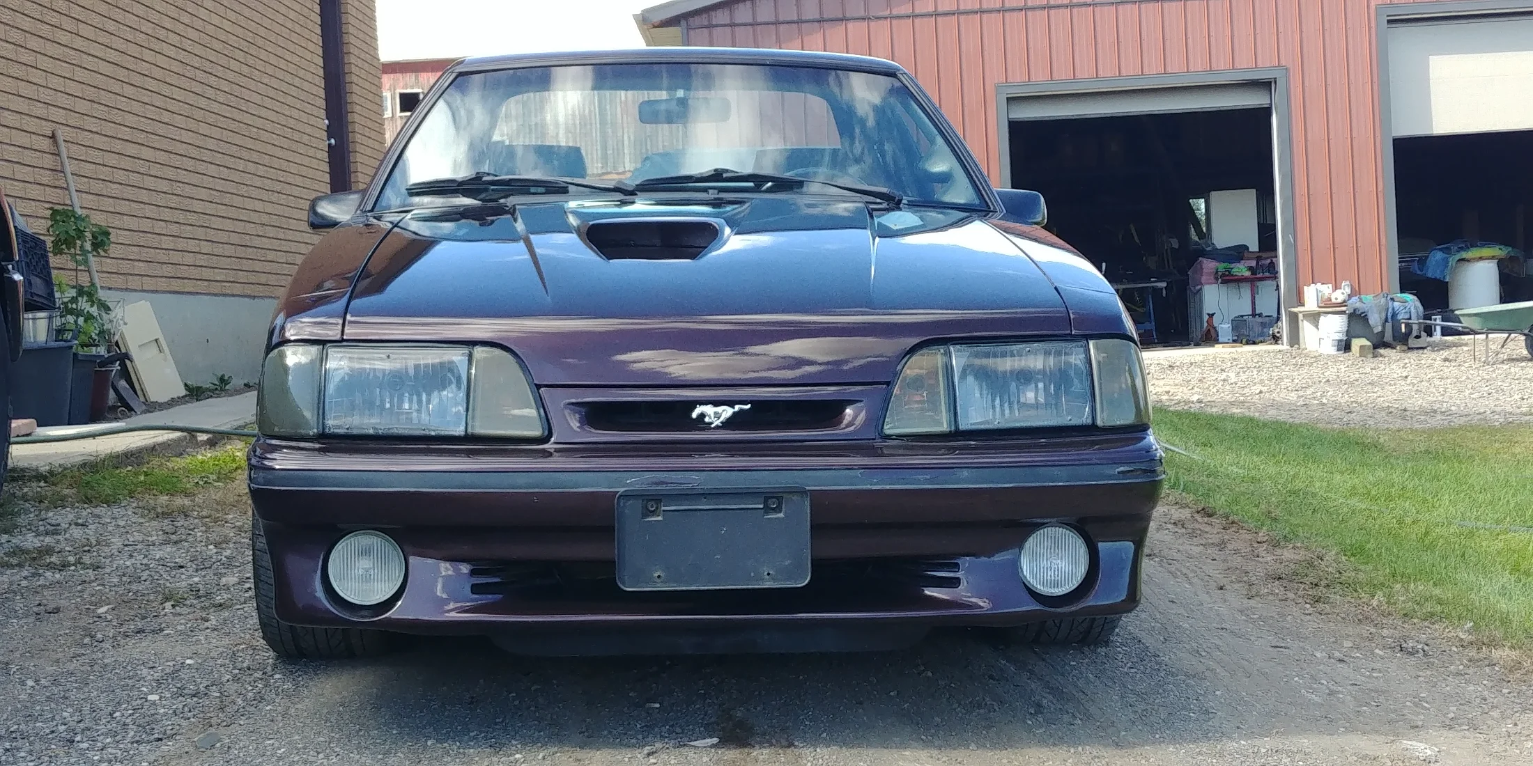

... Or you do a functional hood scoop ...
It's amazing how many people install a 'cold air kit' that has the air filter exposed inches from the exhaust manifold/header. They have no idea what they've done.
