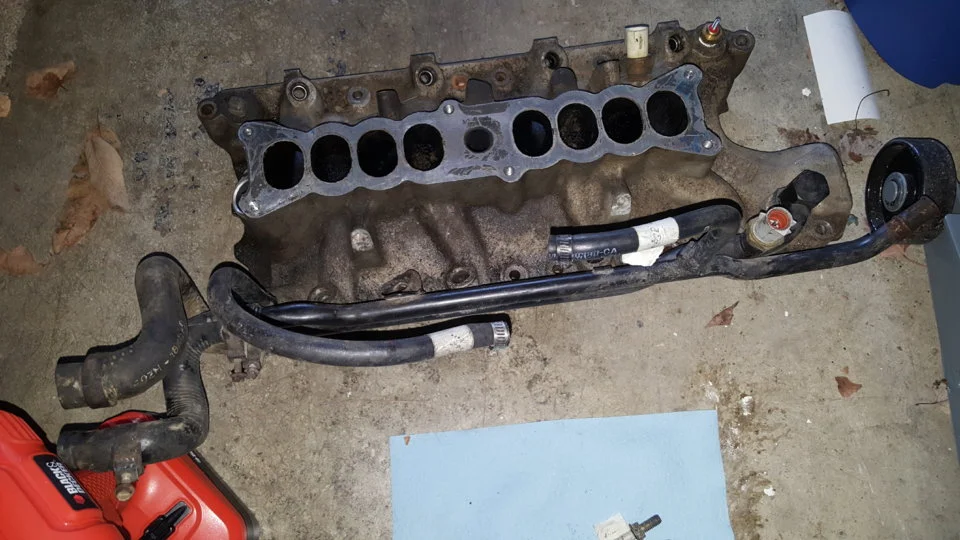

hey guys in the middle of the intake install (pro products). all torn apart and wondering what all goes on new intake. took off all egr hoses and what not and can not seem to break the main bolt lose. hope to finish tomorrow first time for intake install. need suggestions and help as far as what to do with the egr stuff and best way to reinstall without any pains! thanks
