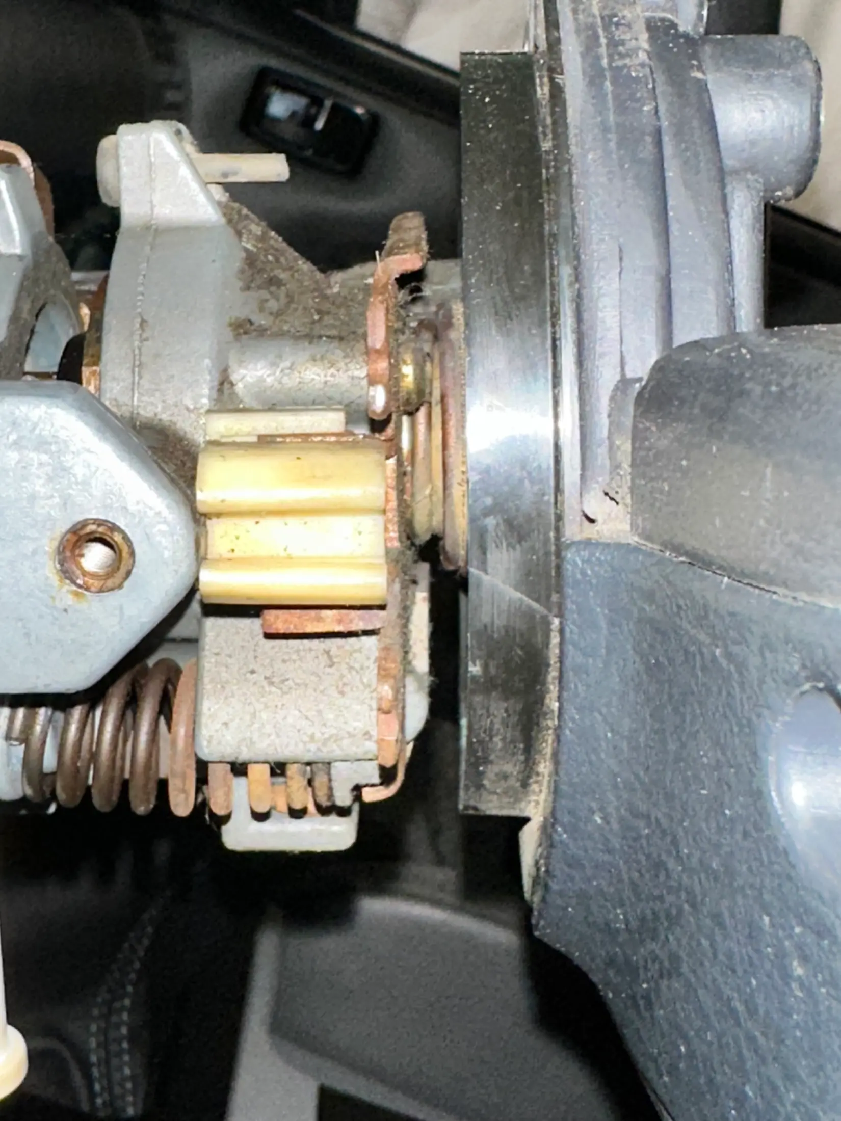

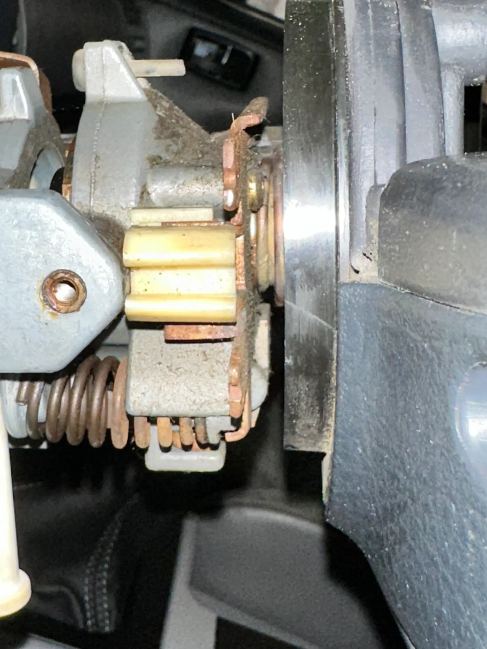

I think when you smacked the rack into place you pushed the steering shaft up the column, it is collapsible somewhat, look at the steering wheel where the collar meets the wheel, is there a gap now?
There are snap rings on the shaft too.
Is this a tilt column?

here’s a photo of where the collar meets the wheel. hope this helps

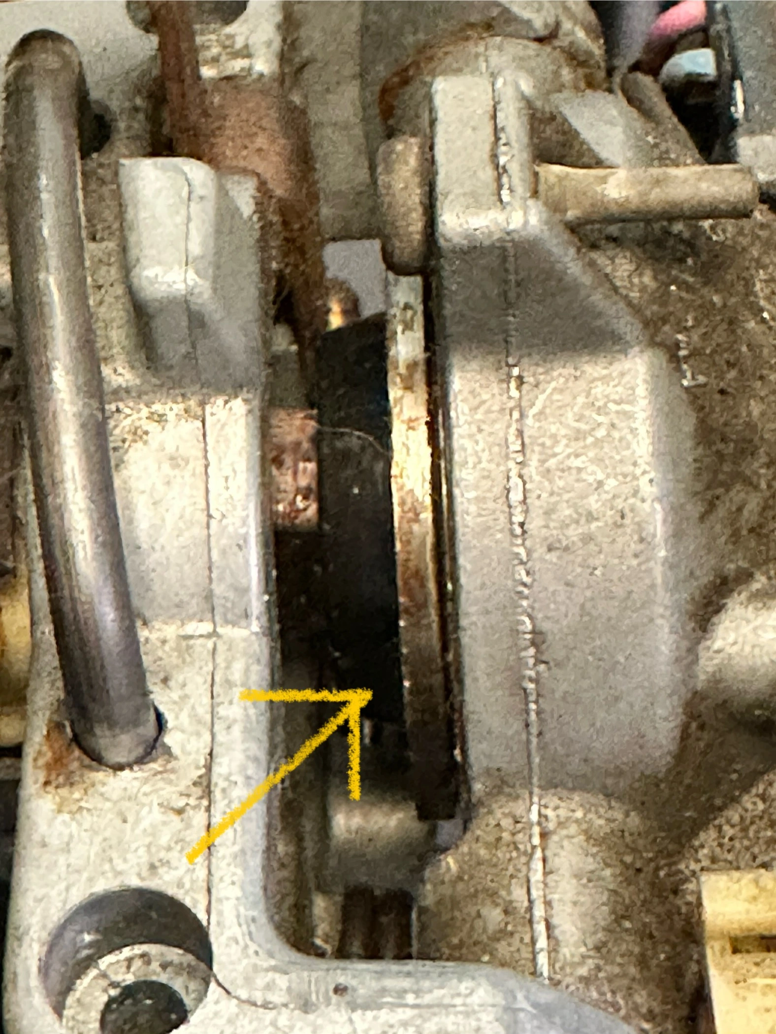

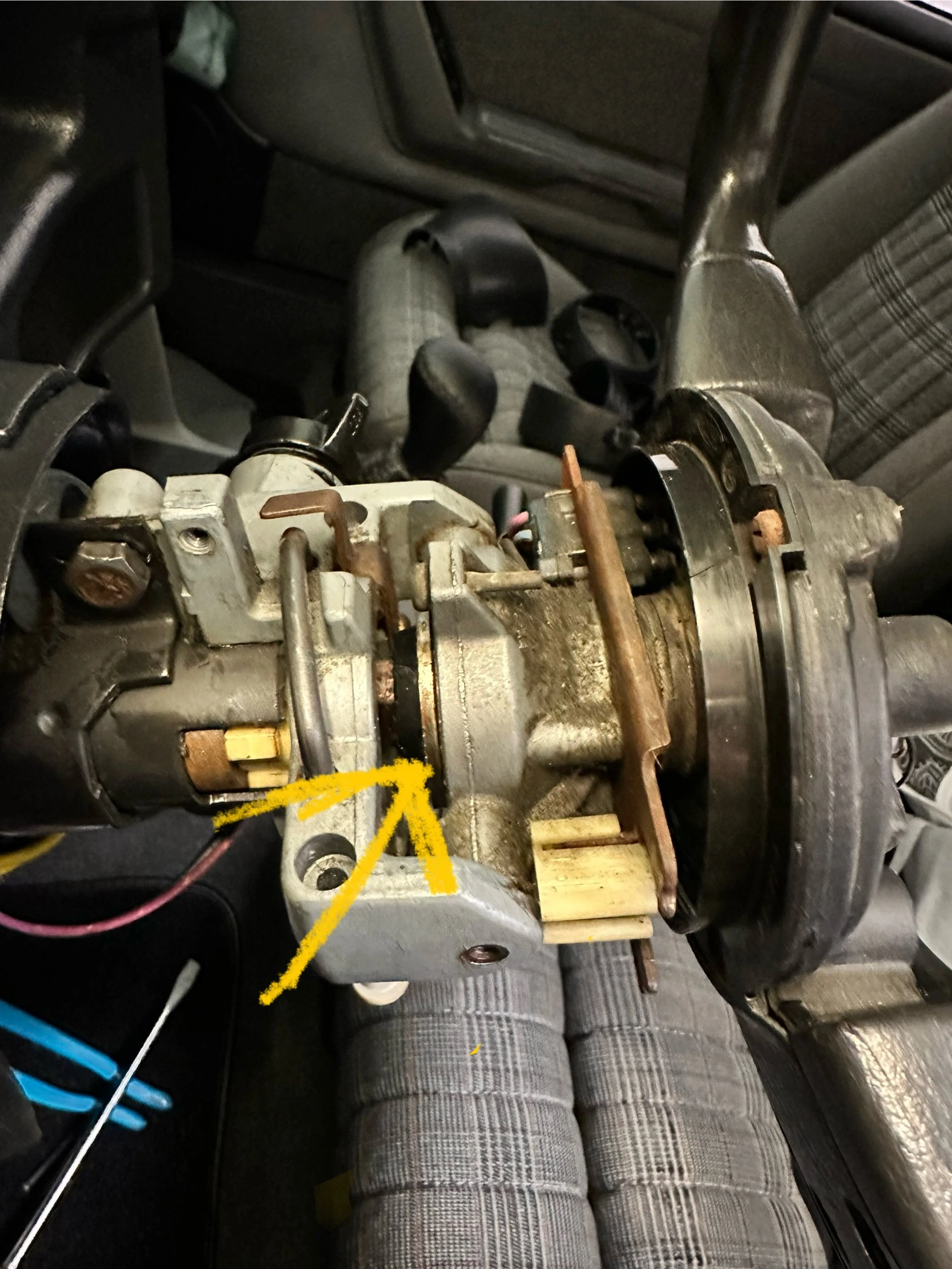

I attempted to unbolt the pinch bolt but leave the other end connected. with a light tap i was able to move the shaft down a fraction but unfortunately it didn’t help the situation. The steering wheel still has play. I think i did narrow it down though. it’s this piece. i tried pointing to it. it’s in there

That looks ok to me comparing two tilt columns in That area.
