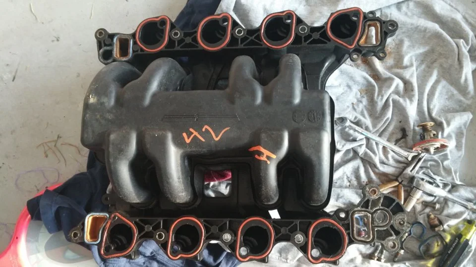

Thanks for the info. Here is a pic of the one that i have that came off of a 97 GT. Let me know what you think if it is a PI or NPI, and if you think it would work on my 00 GT.

Spend the extra cash and get a metal intake, those plastic lower-intakes still leak. That was my correct speculation when Ford motor company did patch job on the intake, that was basically what the coolant cross-over was. Those metal intakes will outlive its usefulness and most people in retrospect.

i would like to get an all aluminum one, but on a budget right now, so just need something to install for now since mine has a crack that is getting bigger and will leak pretty soon.
Buy an OE late model PI intake with the aluminum crossover. The Dorman unit it crap. Smaller ports, poor fitment. I remember seeing a comparison between the Dorman and the Ford intakes one time and it was awful
What everyone else said. The Dorman is designed to fit both PI and npi engines and will hurt overall engine performance. Get the ffrp unit that comes with the aluminum xover your also going to have to get a new alternator bracket, at least i did when I bought my frpp replacement
The dorman intakes will not hurt your motor lol , the Dorman intake is made for that motor , what the dorman will do is nothing as far as performance , the ford racing pi intake will add 14 more horsepower then the dorman pi intake , so go with the ford racing pi intake or a after market intake , Ford starting making the Pi heads and intake in 1999
