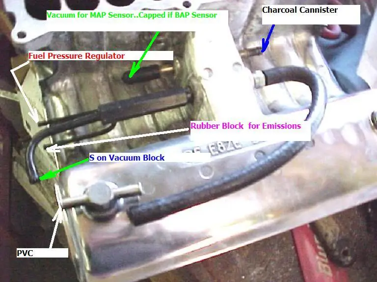

hi guys i got a 91 gt all stock i'm trying to figure out where all vac lines to go from the connections on the underside of the plenum i know the shortest one is capped off and one goes to the vac tree on the drivers side firewall i'm not sure where the smaller ones go any help would be great
:shrug:
Vac diagram from Tmoss,click on it to make it clearer
