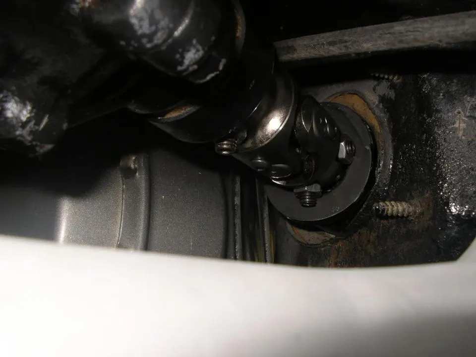

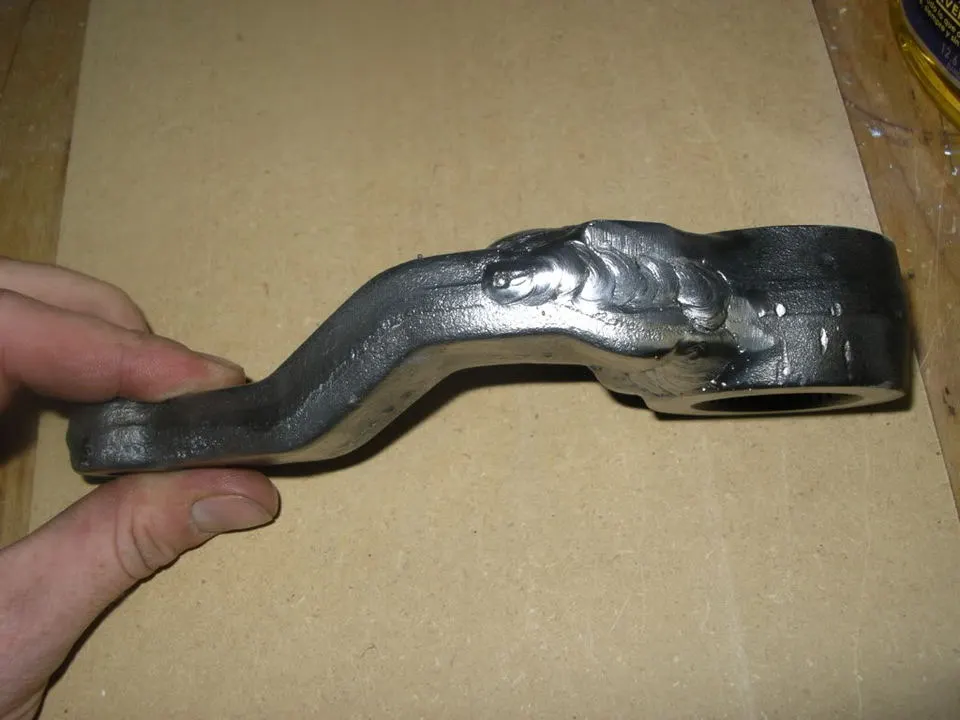

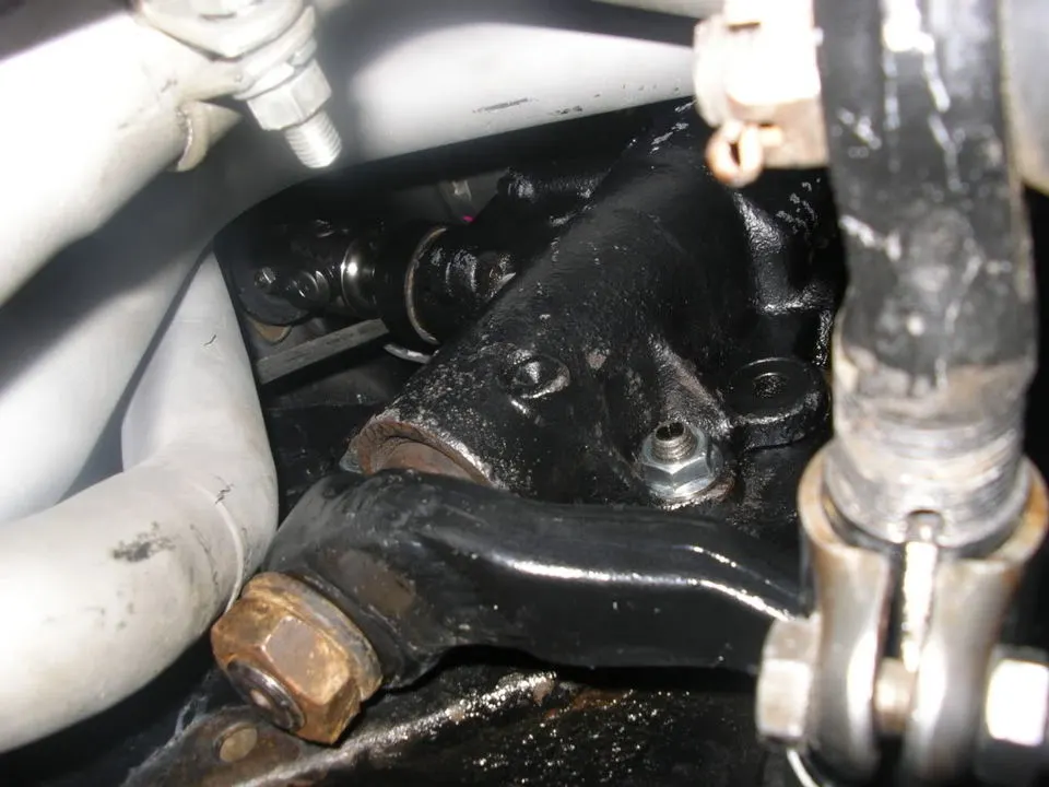

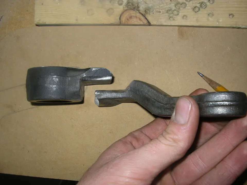

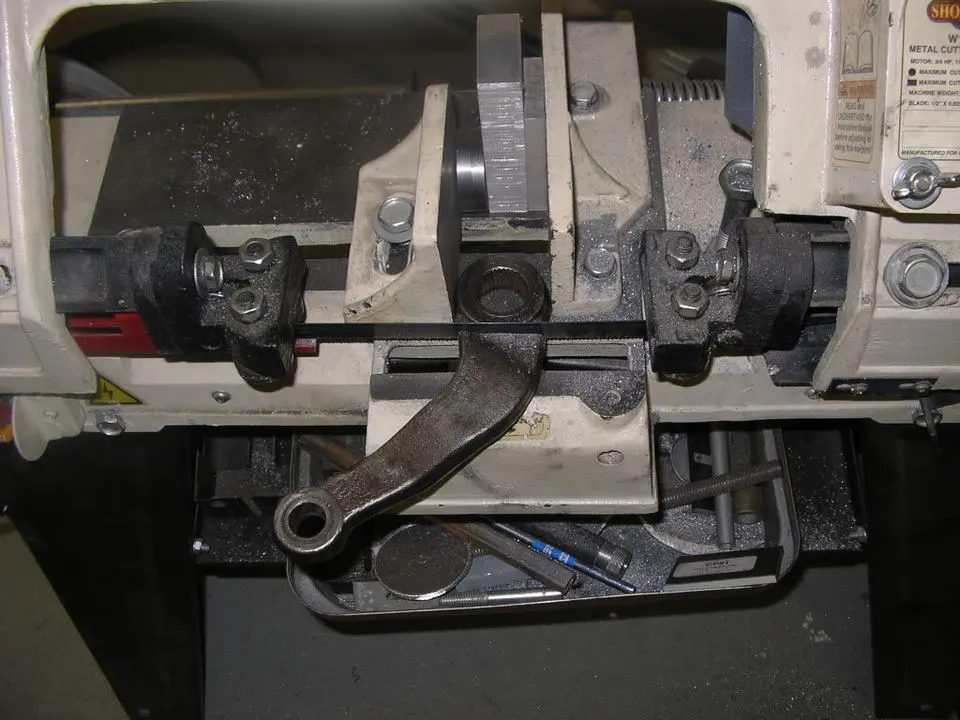

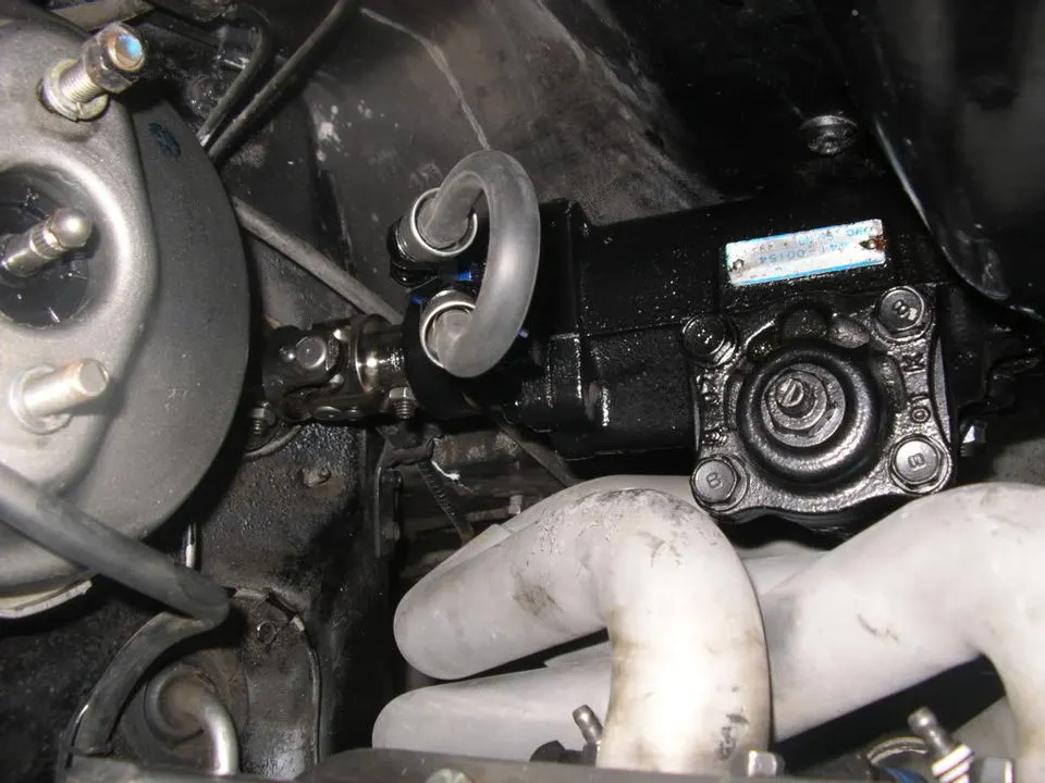

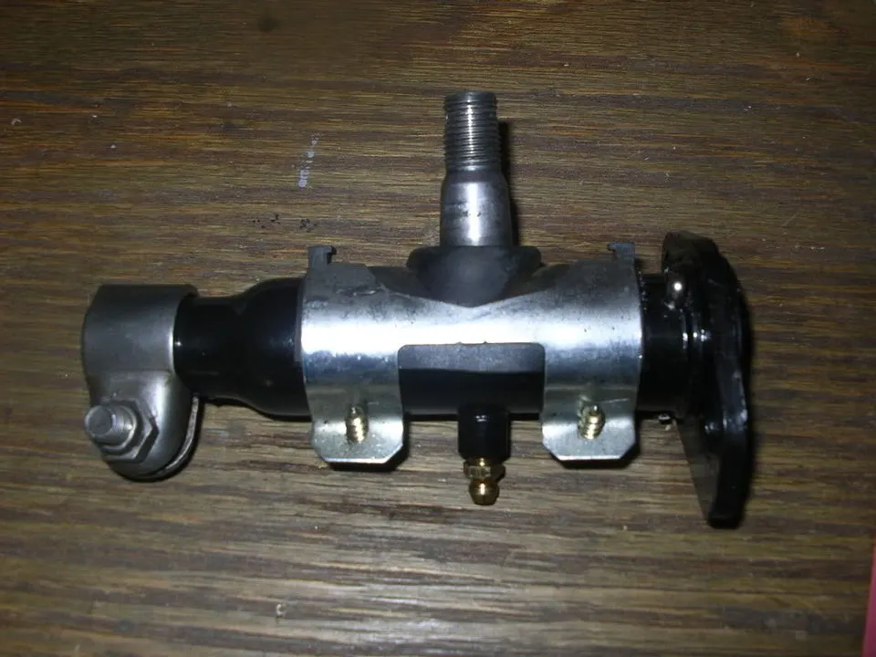

Hey everyone, Its been a while, but here is a quick update. I got everything figured out and installed in the car. I ended up milling both pitman arms down so they would fit together like a puzzle then welding them together. Here are a few pics of the arm, the box all mounted up in the car, and my homeade power to manual steering adapter.
