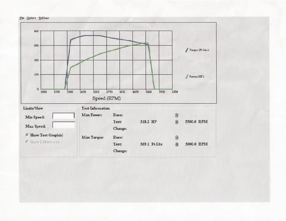

Ill post my dyno tomorrow when i get home and can access my scanner, but here is my graph. Look at my air temps! crazy! he said it spiked from 140-190 in one pull, thats why we suspect the pump, and i still pulled 320hp some how :) (he e-mailed me this)

Thanks, i forgot to repost that i got it to work. What temps do you have normally and whats your outside temp? Also is it normal for the temperature to rise to 200 during boost? Whats a good mixture 50/50? Also my alternator is only half working i have a 200amp on the way, would my car running at 13.2v be the cause of the super fast rise in temps during boost or is this just normal? Does 320hp seem right? I do have a series one with a pulley upgrade, have boost gauge on the way so im not sure what boost im really at.
Here is the dyno i promised, just have been to busy to get it up.
what kind of thermastat do you have? I think that I may have to change to a 160 causing the motor to stay cooler and there would be more timing for the boost.

Mine is stock. I just bought a 180* thermostat i heard 180 is the right number and that 160 is to cold because our modular engines work better when warmer. As for timing that is all about the air intake temp on the engine temp. The air passes through the engine to fast to be heated up, what heats it up is the compressed air that is being made by the supercharger which happens supper fast. I would suggest getting some royal purple adaptive that will make the coolant on your engine and your supercharger cooler, just add it to both reservoir tanks. As for the paint, i just spray painted mine silver :) Removing the paint could be alot harder and more costly.
