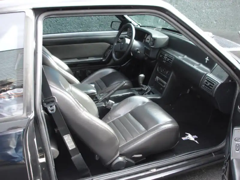

It will fit. This is a 1990 interior in my '88
There are some changes and differences you need to pay attention to, but nothing is a showstopped. 1990 black seatbelts are the only year that will work, so make sure you get them from an actual 1990

nice job on this car it looks awsome and is exactly what my car is gonna look like i got those same seats and i love them.

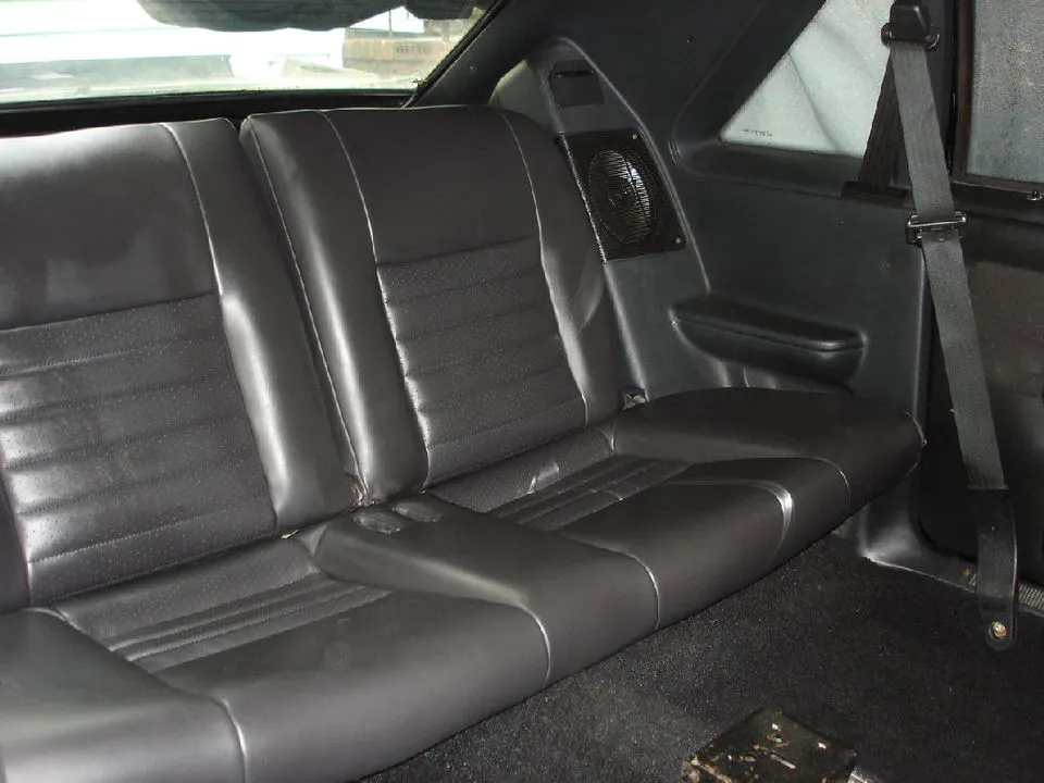

Mustang5L5 said:
Did you do the rear seats as well? did you post pics anywhere. I really only see people with them in the front but id like them to match if i put them in my car.
Yes, Mike did the rears just like I did. Here is a complete thread with pics of my install included:
I did.
