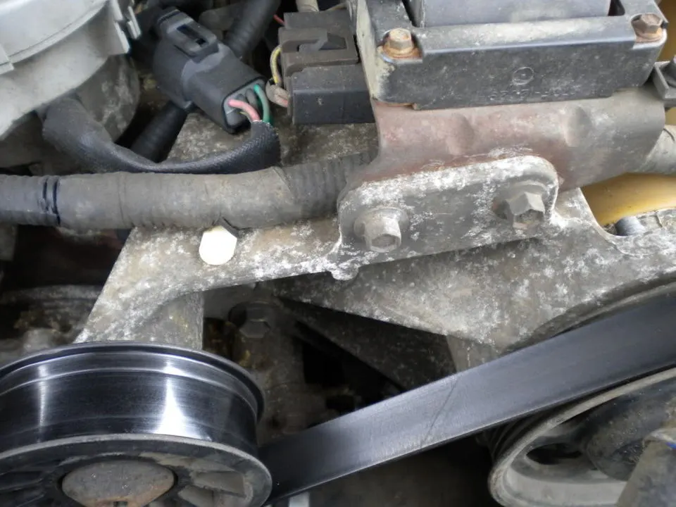

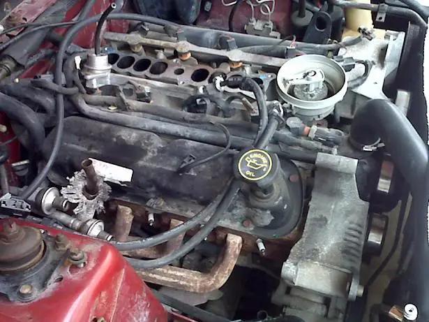

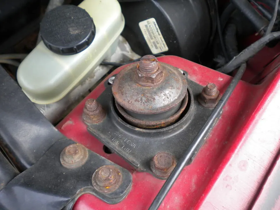

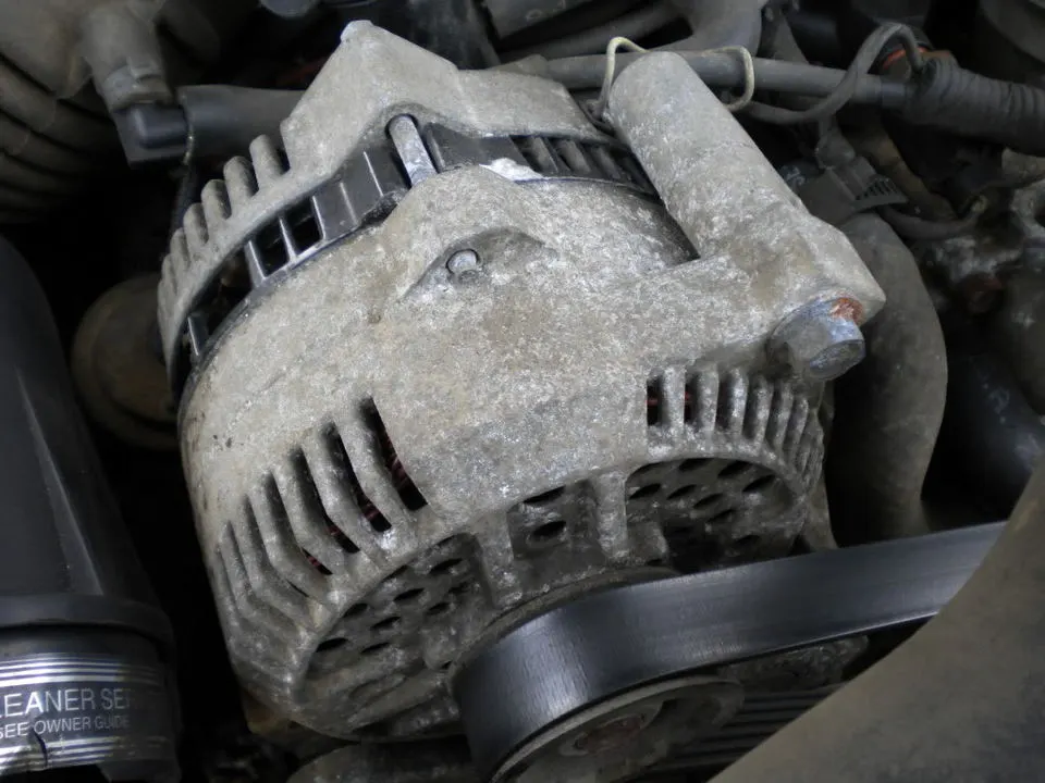

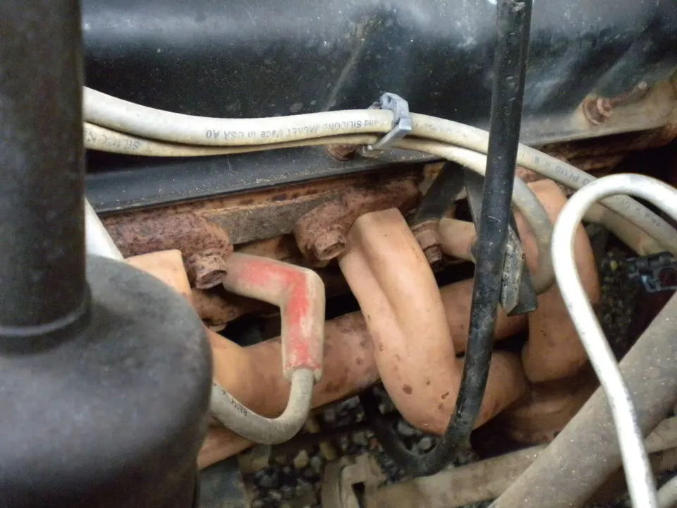

Here are some pics of what I was talking about in the engine compartment.

That's definitely salt buildup. It's just sea salt in the air that builds up on everything. It won't hurt the aluminum, but as you can see it will eventually eat up metal. I used to get salt buildup on my battery terminals too. As stated, it can happen living close to the coast.

That white stuff is more likely aluminum oxide. I've lived on the coast for over 50 years and I've never seen that much build up on any car I've ever owned. I have seen it on cars at auto wreckers/junkyards where the parts are in constant exposure to the elements though. The other rust is likely to have occurred if the car sat unused for a few years in a moist/humid environment.
