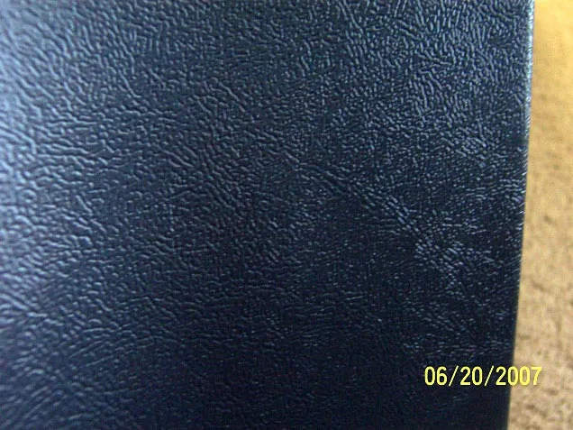

Interior quarter panels refinished
Here's what I got when I used 3 coats of aircraft stripper (or probably any paint stripper would do) on the interior quarter panels. (These are the original metal ones and probably had 10-12 coats of paint on them so they were completely smooth.)
Since the bare metal was exposed I used a thin coat of lacquer primer, after cleaning off the stripper.
Then I used 2 thin coats of blue interior lacquer spray. The blue coats were each thin enough not to fully cover each time.
The next day I used what I'd call a thick coat, but it was just enough to allow full coverage with no runs.
Then I left it in the sun for a couple hours to dry.

Links to what I used
This is what I used to strip the old paint:
http://www.partsamerica.com/productdetail.aspx?MfrCode=MHY&MfrPartNumber=3711&CategoryCode=3272
Of course it's easier to deal with when the parts are off the car so this info may not apply to your particular situation. But a couple tips: spray the product in the shade, scrub with a green scotch brite pad, and use a plastic bondo blade to clean the stripper off the surface and right into a trash bag when it's done working. Don't forget the rubber gloves and goggles or glasses. Wash the part thoroughly with soap and water when done. This product or similar can be purchased in a can to brush on instead.
Here's the primer I used (it's lacquer based for a lacquer or enamel topcoat):
http://www.partsamerica.com/productdetail.aspx?MfrCode=DPL&MfrPartNumber=FP101&CategoryCode=3275
If you are using an enamel or lacquer topcoat in a spray can, make sure the can has a good quailty "fan spray" nozzle, which gives a smoother more consistent paint finish. I used Medium Blue Metallic in spray cans from NPD, but you can buy good spray cans just about anywhere these days if you don't need a Mustang-specific color.
That thinner you are using says "Thins oil-based paint, stain, and varnish" so it wouldn't remove a lacquer if that's what you have on your interior now. Maybe you can post a pic of your interior? If the grain's not too bad, you may want to just scuff up what's there and paint over it.

Your quarters look much better than mine when I started. You have half as much paint on them.
For the quarters I would strip them down the way I described. It's really the easiest way to go and the results speak for themselves, if I say so myself....
I did 3 stripper coats per quarter which ended up being close to 2 cans total. You might need half that.
I wouldn't use a screwdriver blade for anything here except loosening or tightening screws. The blade could easily scratch up the metal surface and the scratches will show through.
