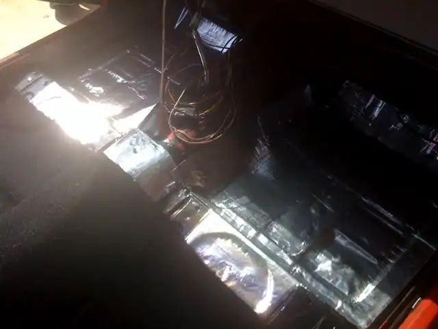

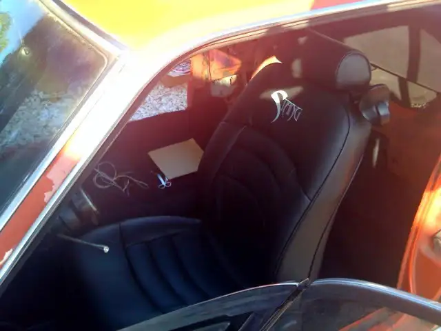

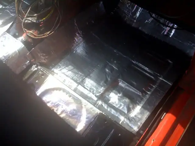

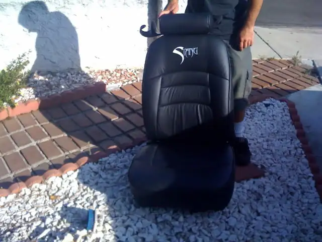

Okay, last weekend got the Por 15 on and this weekend got the Damplifier Pro, Overkill Pro, carpet and seats (which were just wrapped in new leather)

Who made your upolstery?
Did you lower the seat risers for those seats?

The leather is from Katzkin and it was put on at ASC in San Diego. The seat risers are still there and there are no clearance problems.

You must be real short.
I have the stock seats and the seats I have out of an '03 are almost 2" higher. It is impossible to cycle the clutch and not have your leg catch the bottom of the steering wheel. I'm taller than 6'2" so I doubt I could drive my car at the track with a helmet anymore.
I can see from the pics you have an automatic so this probablly isn't a big deal for you.

I wouldn't consider 5'10" "real short" but I doubt many guys over 6 ft would be comfortable in my car. These seats are from a 94 and when next to the stock bottoms they definitely aren't 2 inches taller. By the way, that's not me in the pic with the seat, that's my buddy that helped me get everything in and he's a bit shorter than me.

I'll measure both seats and post pictures in a couple of days. They are in the parts loft part of my garage, and I can't get them down right now.
