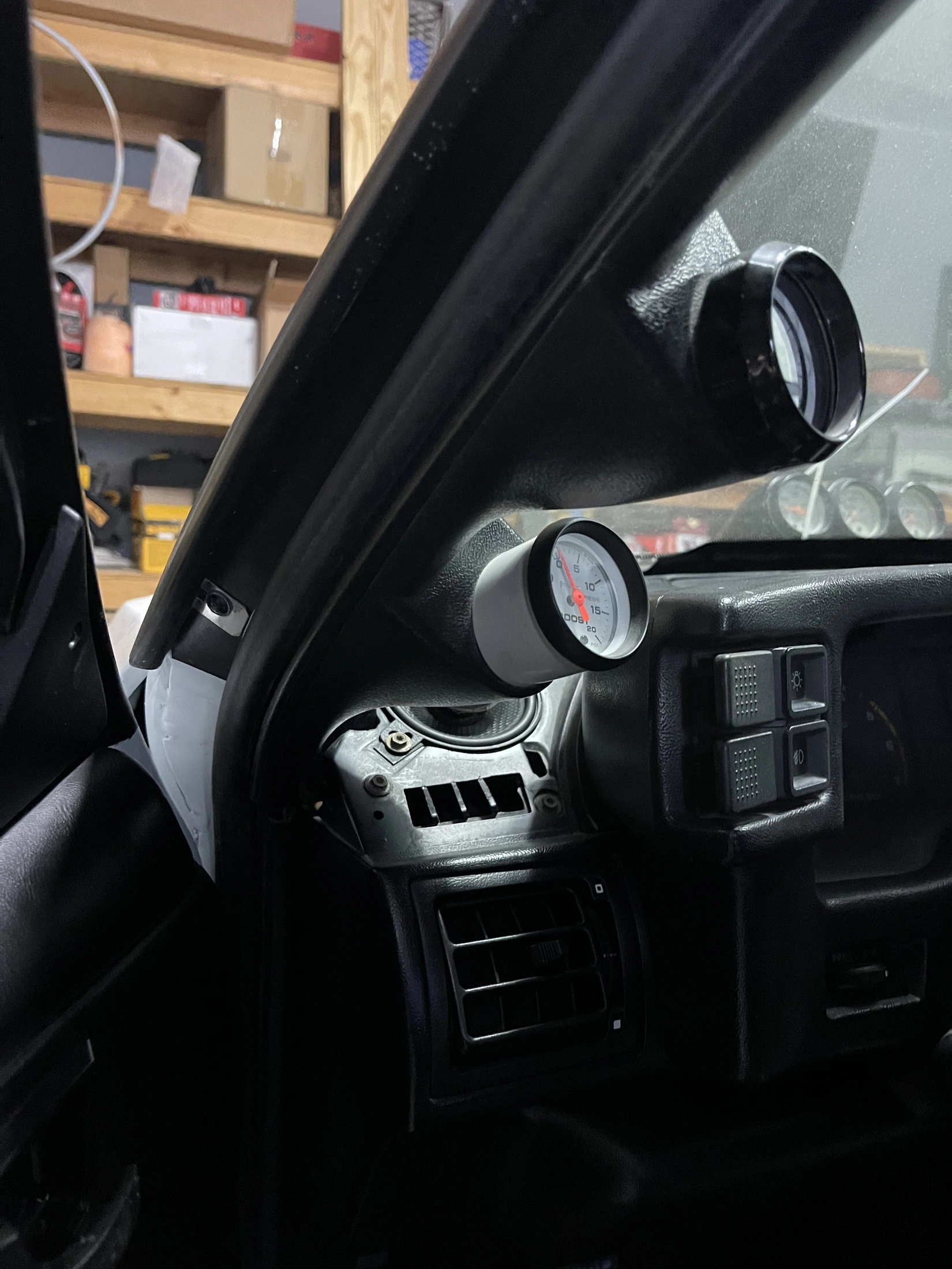

I finally got the gauge pillar on. But now my boost gauge doesn’t work if I seat it flush into the pod. If I pull it out as in the picture it works. Thinking the vacuum line might be kinked when seated all the way in. Might have to pull the pillar back off some and check the line. Plus I can’t get my speaker grill back on with the gauge pillar installed. Going to try again tomorrow.

You need to remove your factory A pillar trim and install that gauge pillar in its place. That is why your boost gauge isn't fitting properly. I have the gauge pod you add over the factory A pillar trim.
When you remove the factory trim the gauge pod will now fit (like factory) and have room for your wiring and tubing down the pillar.
You should be able to get hold of the vac line going to the gauge as it runs down the pillar.
Gently, pull the line [down] the pillar as you push the gauge in.
